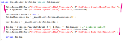

Hi @Luis.Romero, @devneetmohanty07 ,
Just to update, the version on the DX is 10.4.2, I have located 4 lines in a method called GetFolder. I have now removed these lines and will be updating the asset shortly. The new version will be 10.4.3.
The file attached shows the problematic lines and as an interim fix they can be removed.
Once again, apologies for the issue.
