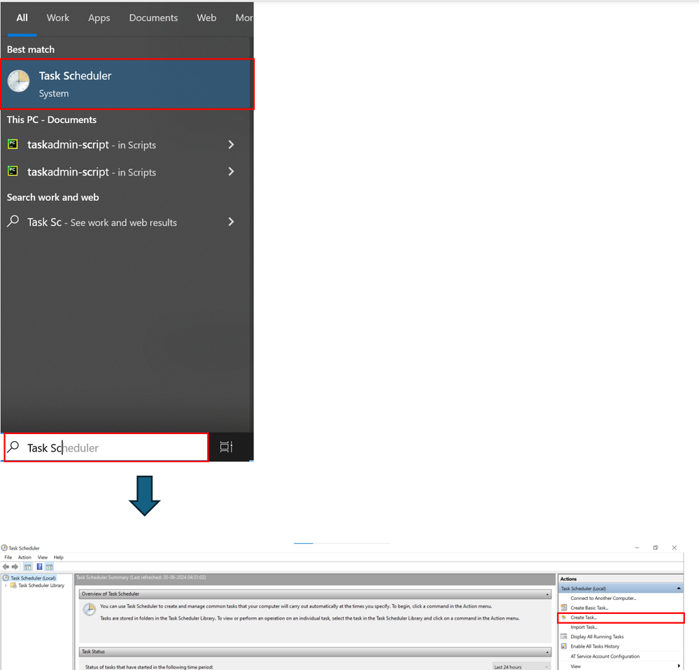

Once the script has been created, save the python file in some directory and we will create the schedule in Task Scheduler and click on Create Task option from the Actions panel:

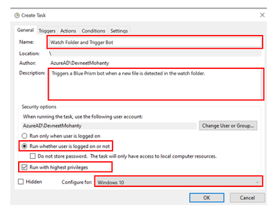

Provide the task name, description and select the options: Run whether user is logged on or not and Run with highest privileges and select the Operating System:

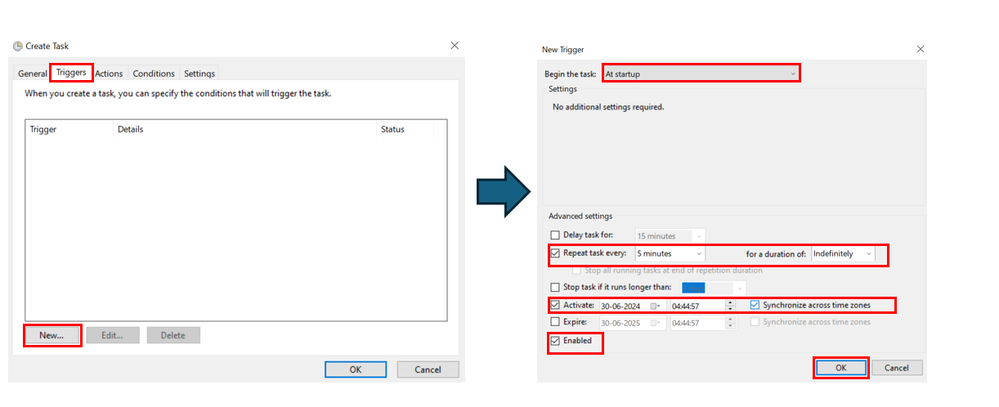

Now, click on Triggers tab at top and provide the Trigger to be at startup and repeat every 5 minutes indefinitely as shown below:
