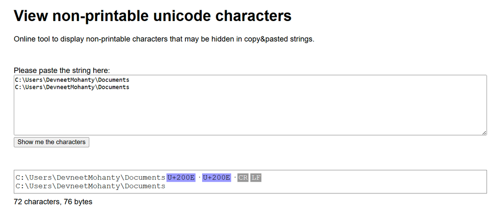

Hi @PeterHeyburn123 ,
Can you try this out once:
On this website , try to paste the path that you are getting from Blue Prism calculation stage result and also paste the path that you get from the 'Copy As Path' option when you manually press 'Shift' + Right Click on the file from File Explorer.
This will tell us what hidden characters are exactly present. My guess here is in your config file you may have these characters that is messing up the overall structure:

That's a very useful tool, it has revealed that when Blue Prism reads in values from the config file, it is adding Unicode characters 'U+202A' which appears to be Left-to-Right Embedding. I have verified that the text string I am adding to the config does not contain those characters, but they are present immediately after I use the 'Get Worksheet as Collection' action within the 'MS Excel VBO'.
I suppose I could just remove these characters, however I would be concerned that the issue may crop up elsewhere.
Have you seen this before?
