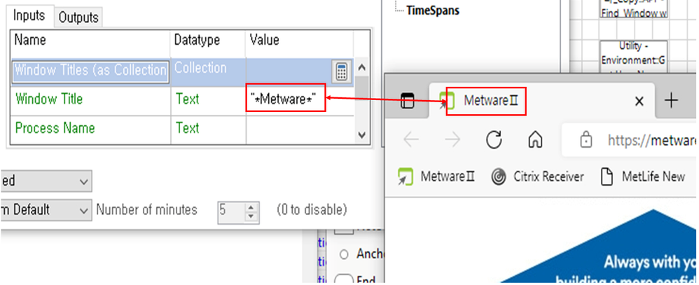

We're testing the Attach using Windows Title in the Edge browser
The text itself looks identical but it's not working. Is there any way to troubleshoot this?
Please note that specifically, this is the case when the browser has been launched by "Start Process".
FYI, it was also tested with using PID and Process Name which seems not working in the case of modern browser where multiple instances are being invoked at the same time.
<Navigate stage - Attach>                                                                                                        <Windows Title of the browser>

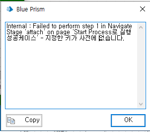

The error message is like this:
Internal: failed to perform step 1 in Navigate Stage 'attach' on page 'Start Process xxxx' - designated key not fond in the dictionary.

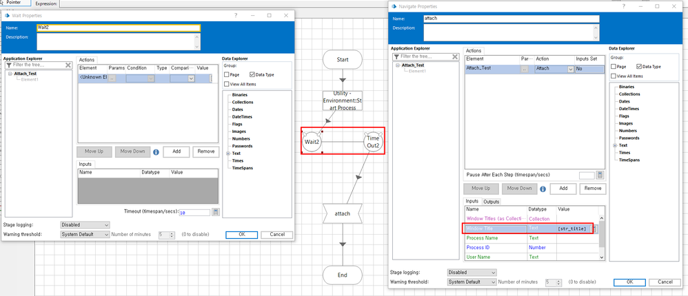

The test logic is as simple as shown below with enough Wait timer > 10s.
The Thing is that the spying works when it is launched via Application Modeler or Navigate stage.
As it happens only when the browser is launched by "Start Process" and apply "Attach" (thereby, it might also happen when the browser is to be re-attached later), I'm wondering if there's any difference in their behaviors between using "Navigate" Launch stage and using "Start Process"+"Attach" stages.

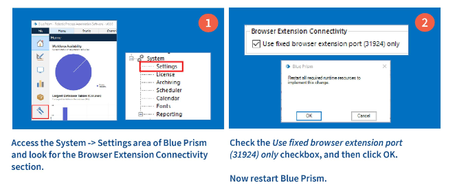

If you are using multiple objects and unable to attach from other objects, you need to enable "Use fixed browser extension port (31924) only" option in the System > Setting >Browser Extension Capability. Hope this will resolve the issue.
Sahana Mohan
Solution Designer
Blueprism
Sahana Mohan Lead Software Engineer SS&C Blue Prism
