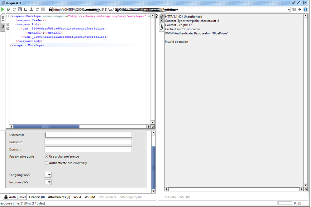

Hi Everyone,
I am trying to launch an already exposed BP process via SoapUI. The process is expoxed correctly and I can use its link. The Question I have is , how do we fill in the authorisathion section> username , password and domain. I currently have the process running on a vdi on the companys domain.

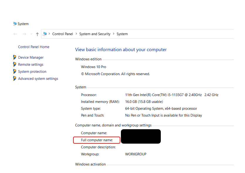

03-06-22 07:03 AM
Hi Andrei,
I think it is not any internal Blue Prism 7 internal JWT token at all and instead looks like you are calling an exposed process/object. Try to give the Fully Qualified Domain Name there along with your username and password and check the results.
For simplicity, you can also use Wizdler extension in Chrome. Refer to this video: https://www.youtube.com/watch?v=x2KsQhJqo9I
