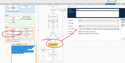

Does anyone have experience using this object? If I step through the object it is failing at the 'Set Range Value' step with the Status Code 400:
Our 'Utility - JSON' object is the latest v10.0.1.
