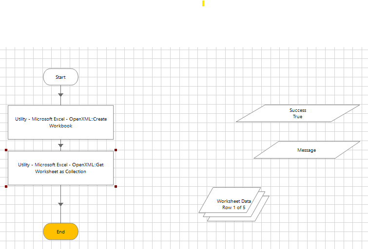

GeoffHirst
Hi @Neel1
After testing the asset with V2.19 of the DocumentFormat.OpenXml.dll I am finding it to be working fine with V7.4.1 of Blue Prism desktop.
I may update the asset with an example process and possibly a video in the coming days to align this asset with others that we have done this for.
If you have any further issues with the asset, please come back here and let us know.
