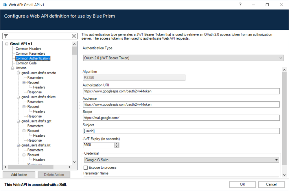

4. when all configurations are done you need to change properties of the Common Authentication parameters in Authorization URI and Audience like in the image below. The scope and subject depends on your environment and requirement.

Changing the Common Authentication definition should not be required, at least it wasn't for me. However, as Zdeněk mentioned, you will have to have a company deployment of G-Suite to test this using a Google Service Account. That means you will also have to have a domain name that you can tie to the G-Suite configuration.
I did continue to receive the 400 error for quite a while after setting up my G-Suite though. I ended up restarting my Blue Prism client a few times and then things started working correctly. Not sure if that was an issue of something having been cached from the initial failed attempts or what.
It looks like I spoke to soon. 😭 You do have to set the value of Subject on the Common Authentication page. However, instead of hard coding the value you can set it to the value of the userId input parameter that is required on every method. What this ends up doing is telling Google which specific user the service account is requesting delegated authority for. Here's what my Common Authentication section looks like:

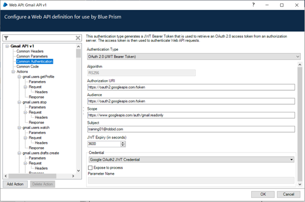

Hi @ewilson: Thanks for responding. I have updated my API KEY in Credentials under "Google OAuth2 JWT Credential" in below format
'----- BEGIN PRIVATE KEY -----'\n AIza---kuE \n'----- END PRIVATE KEY -----'\n. While Executing getprofile I am getting below error. Can you help me with the exact format to be used for updating the key in credentials. I tried multiple approach but still no luck.
Error Message: "Internal : Unexpected error PKCS8 data must be contained within '-----BEGIN PRIVATE KEY-----' and '-----END PRIVATE KEY-----'.
Parameter name: privateKey".
Attaching the screen shot for your reference from the common authentication. Thanks once agiain for your support.
