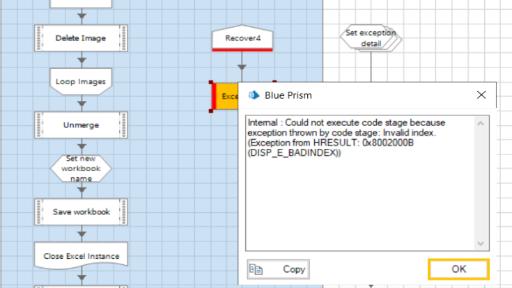

Has anyone use this shared asset in DX? I tried it but got an error below when executing the code stage for Save As.
Could not execute code stage because exception is thrown by code stage: Invalid index. (Exception from HRESULT: 0x8002000B (DISP_E_BADINDEX))

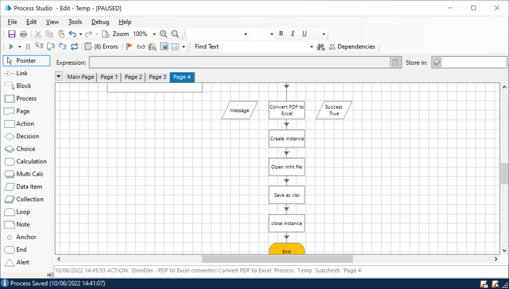

Beyond this I think the only other thing you could do is, since it fails but still produces the mht file, you can then use the standard excel object actions to open this mht file and resave as an xlsx. This will give you what you need it to be, the convert object only seems to fail on the final step of saving the file as an xlsx so as long as you can get the mht file then you only need to add a few steps to your process to get the final output file. See my other screenshot for an example.

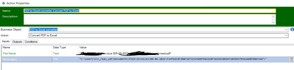

Hi Dhenn
Can you share the input values you are entering for the object?
Michael ONeil
Technical Lead developer
NTTData
#MVP
This is my input:

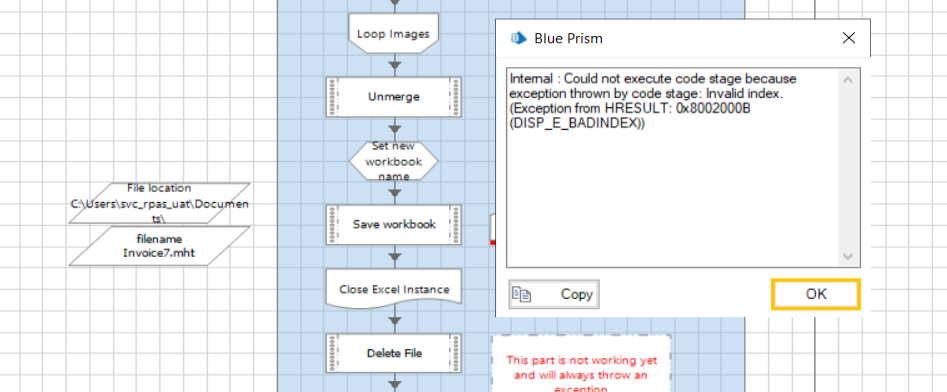

This is the error when attempting to save the workbook.

Hi @Michael ONeil, I replied my inputs below. I am using BP7​

I tried to recreate the same error and I'm able to see the same Index error message. (Note: I'm not able to select any text in the PDF that I tested)

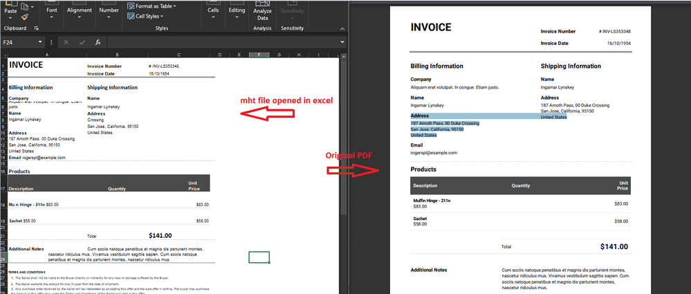

To test further I took a PDF that was selectable and fully digital so I was able to convert it successfully. Check the snapshots. Also attaching the PDF if you want to try it.
So this might be the limitation that it is able to convert the PDF which is in full digital and selectable format instead of scanned PDF which uses images.

Still doesn't solve the error even I used your own PDF as you attached. My PDFs are not images or scanned PDFs, they are structured and have selectable text and tables as well.
See error below:
The error encountered when going to "Save workbook" code stage. The conversion from pdf to excel was not successful and it just leaving me a ".mht" file.
