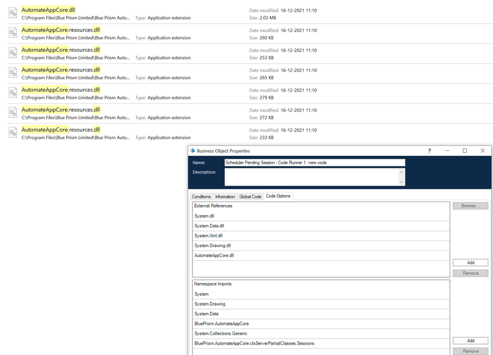

Strangely, if you downloaded the asset from the link as mentioned by @David-Dinh you should not face any compilation issues as I also am not facing the same. But, the issue you are facing is most likely a reference call issue with some missing DLL or namespace import. Can you verify once if you have the AutomateAppCore.dll file under your Blue Prism installation folder or not.
If you have that, then please cross check once if the namespace imports and the external references provided in the below screenshots are matching or not?
For your ease, the namespace imports are:
  • System
  • System.Drawing
  • System.Data
  • BluePrism.AutomateAppCore
  • System.Collections.Generic
  • BluePrism.AutomateAppCore.clsServerPartialClasses.Sessions
And, the external references are:
  • System.dll
  • System.Data.dll
  • System.Xml.dll
  • System.Drawing.dll
  • AutomateAppCore.dll
Hope it helps you out and if my solution resolves your query, then please mark it as the best answer

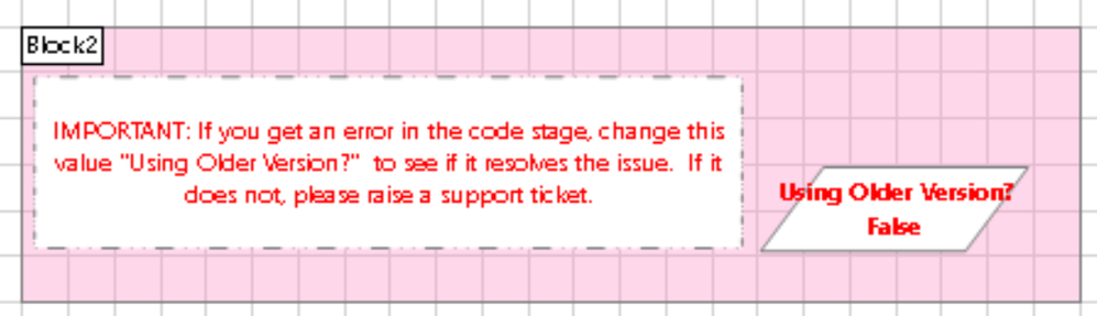

Hi Nilanshu,
There is a switch called "Using Older Version?".  Can you try it both ways and see if it corrects the issue for you?  If it does not, please submit a trouble ticket and request "David Dinh" in US.  We can set up a working session to get you going.
