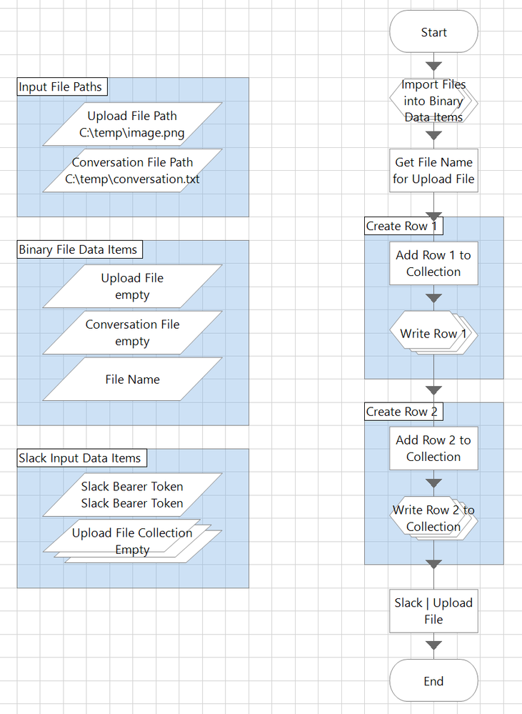

Glad to hear it is working! I have attached an example process that you can download here and import into your Blue Prism environment that may be helpful for you (need to unzip file first). I already have my image file and my conversation.txt file created on my computer so I know the file paths for those (these are the Input File Paths data items). From here, the process will do the rest of the work of putting the Collection together so that the Upload File action is successful. Here is what it looks like:
So, you are on the right track - start by bringing your files in as Binary data items. Then I use the Split Path action from the Utility - File Management object. You will see this action has an output parameter called File Name which will give us the name of the file that we need to include in the File Name field in the Upload File Collection.
From there, I add a row to my Upload File Collection and then a Multi-Calc stage to write all the fields at once. The [File Name] data item is the output of the Split Path action. And Field Name will always just be
I do something similar for row 2, to add the conversations.txt file. And finally, the collection is prepared for the Slack Upload File action.
If you can import my example process into your own environment, you will be able to see how I set up the input and output parameters for each stage to make this work.
"file"
for this case - here is how it looks for creating Row 1:I do something similar for row 2, to add the conversations.txt file. And finally, the collection is prepared for the Slack Upload File action.

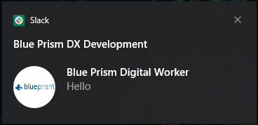

Last item I will note is the "Text" input parameter for the Post Message (Blocks) action. If you provide some text for this input parameter, it will show it in the notification for the user that receives the Slack message.
If you leave it blank, the notification will look like this:

function to make the change. Here I am changing the word "well" to "great":Last item I will note is the "Text" input parameter for the Post Message (Blocks) action. If you provide some text for this input parameter, it will show it in the notification for the user that receives the Slack message.
