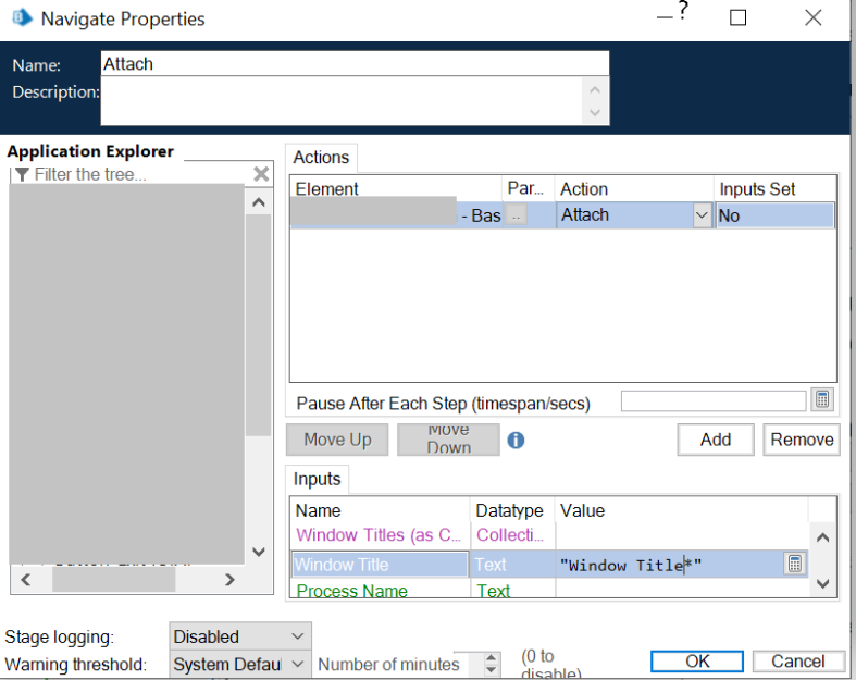

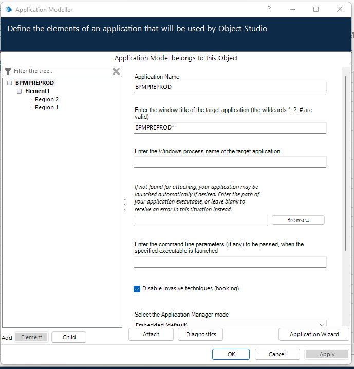

I'm trying to attach to this window of VMware but I'm unable to. It should only be attachable once it's opened so I've set it this way. Setting the executable path defeats the purpose, so this is not an option for me.
I'm trying to attach to this window. Using the parameters below.

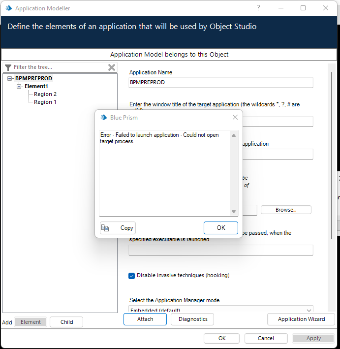

And here's the error I get once I try to attach
Any idea on how to solve this? I remember it was once able to attach. But I don't know why suddenly I'm unable to.

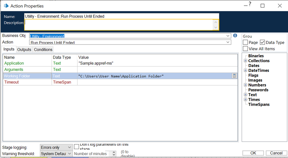

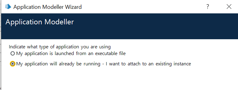

Hi @Oscar Lopez , Have you tried starting the application by "Run Process Until Ended" - and then tried attaching it? If not please try doing this way of launching your windows app and then reconfigure the modeller to attach to a running/existing Instance !
Utility Environment : Run Process Until Ended - Give the folder path where the application is and then give the application starter, refer below snippet:
