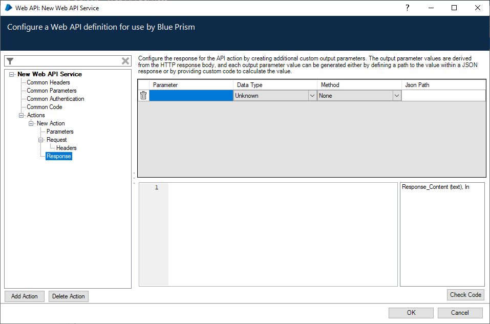

2. In the Web API Service, is there anything configured in the Response section for this request? If this section is blank, we will know that the Response Content is not being altered here.

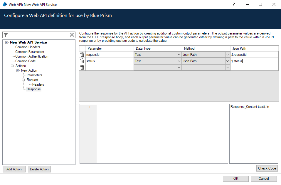

4. Lastly, what happens if you set up the Response page to look something like this? You will need to declare those parameters listed here and then set them up as Data Items in your object/process:
In my experience, Blue Prism does not alter the Response Content by default, so it would not quietly substitute an 'undefined' value into a JSON body. That Response Content should truly just be a string representation of what the server returned. Usually when Blue Prism fails to parse something, it will throw an exception message and stop the process/object.

2.a. Response setting was blank when API calls was sent previously.
4. Tried it but ​got blank/empty string response from created Response parameters
