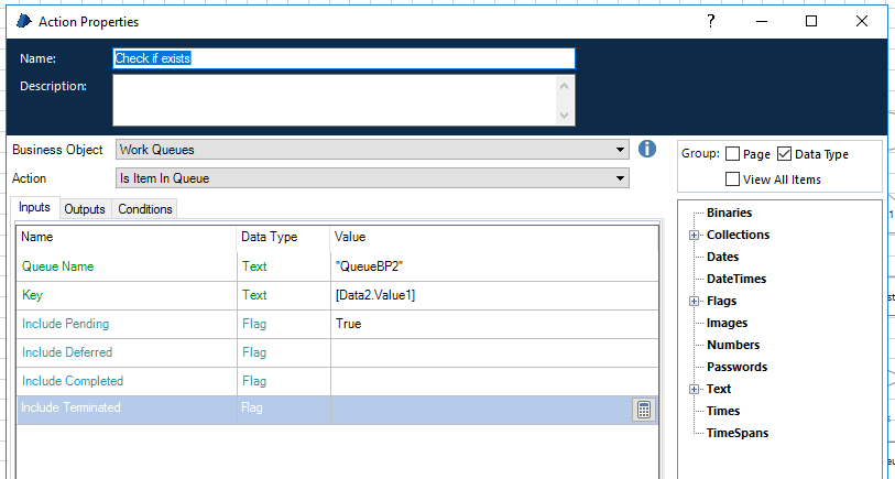

Use the action "Is Item In Queue" from the Object "Work Queues".
This action returns you a flag indicating if the item exists or not

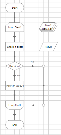

Your Process should looks like this:
In the "check if exists" action stage I call the "Is Item In Queue" action. You can filter here including completed, terminated, deferred and pending items
