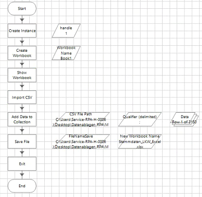

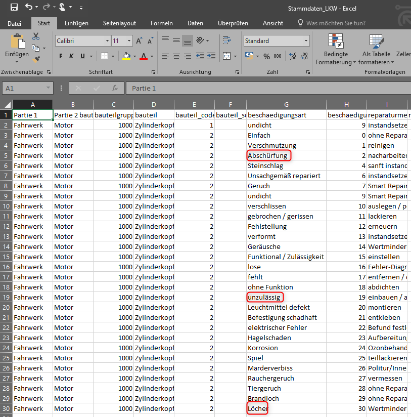

When Blue Prism opens the CSV file, the format is realy unstructured (Pic1 Attachment). The strang thing ist that when i open the CSV by myself, it looks correct.
My Process (Pic2) is working and saves the CSV as an XLSX BUT the format is still like in Pic1.

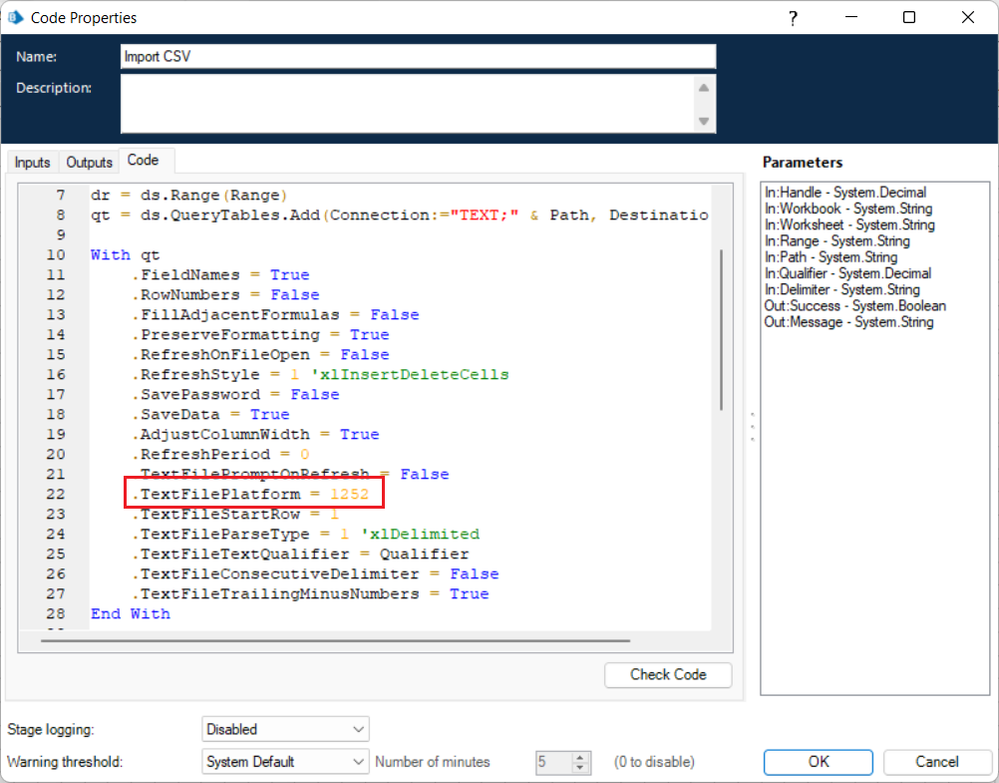

Within the Code stage of the Import CSV action you should see the following line:
qt = ds.QueryTables.Add(Connection:="TEXT;" & Path, Destination:=dr)​
Try changing that to the following:
qt = ds.QueryTables.Add(Connection:="TEXT;" & Path & ";CharacterSet=UNICODE;", Destination:=dr)
Eric
ewilson
@NiklasFranke,

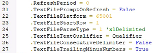

Ignore my last comment. Instead of changing the connection string you need to change the value of the .TextFilePlatform property in the Code stage. You should see this section of code:
Change the value of .TextFilePlatform from 437 to 65001 and you should be good to go.
UPDATE - FWIW we've updated the Excel VBO on the DX to include this change.

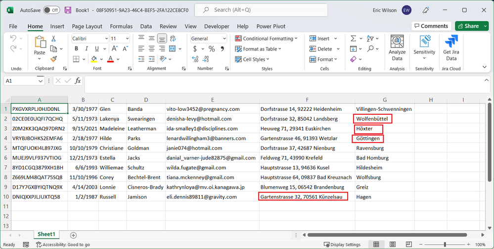

There may be something wrong with your test data. I tried using the CSV you sent, but there were no special characters included in it that I saw whether I viewed it in Excel or in my UTF-8 text editor. So I went to this site​ and generated some test data that included German characters. Here's the data I end up with:

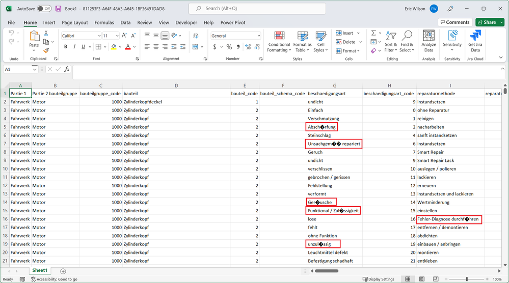

It didn't give me a lot of special German characters, but there are a few and I set it up to use the semi-colon as the delimiter. Here's what the data looks like after importing it into my Excel:
So it seems to be working.

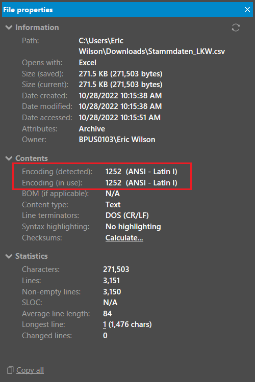

I opened your test data in my editor and checked the file properties. This is what UltraEdit detects as the encoding of the CSV file:
And this is what I see after importing your data into Excel:

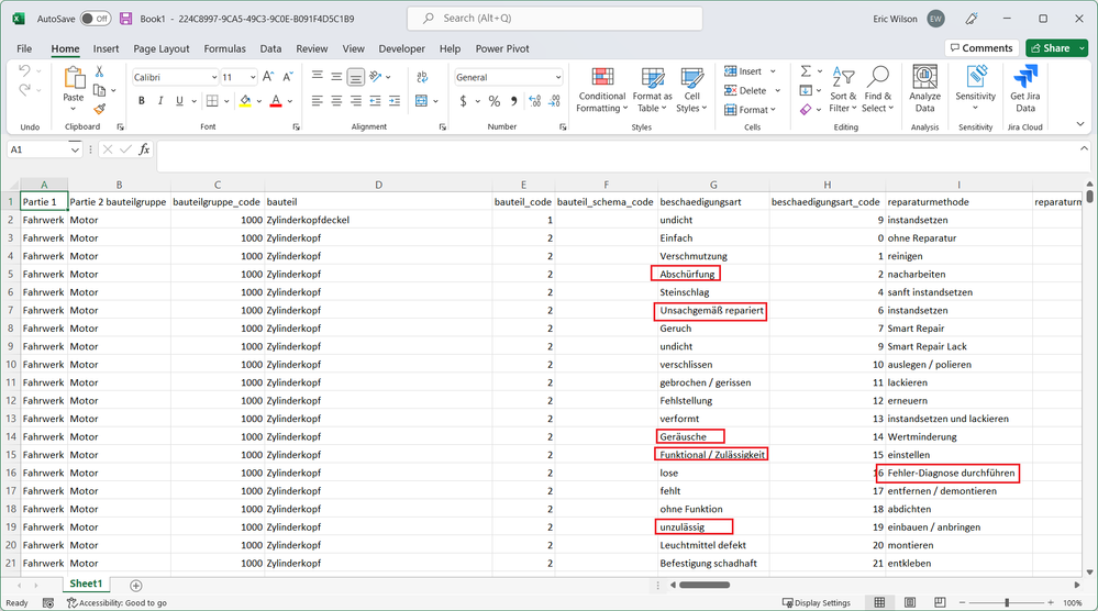

Now, if I change the code page in the VBO from 65001 to 1252, as shown below:
This is what I see after importing the data into Excel:
So it seems 1252 is the magic code page for your CSV. I think what we'll do is change the Import CSV action such that you can provide the code page value as optional input.

@NiklasFranke,
We've just posted version 10.0.2 of the Excel VBO. This includes a optional input parameter on the Import CSV action for specifying the encoding code page.
Eric​
