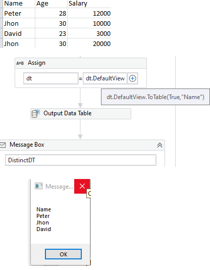

Can follow below sample
Neeraj
9999254723
Hi
Please find the solution below.
1307.pngHope, your query is resolved now.
