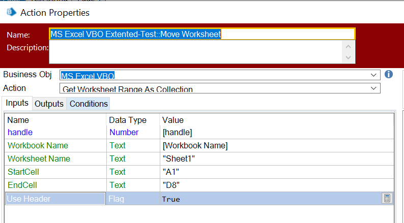

1) Use Get worksheet range as collection (Identify the last cell of your table - 1 and do not disturb the column which has formulas)
2) Edit your collection with your data and rewrite this collection on excel sheet.

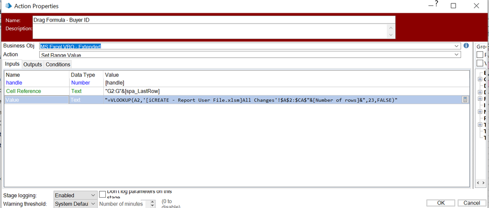

Alternatively- If you want to set formulas in any column of your collection - You need to identify the last row of your column where you need to put formulas , Use Set Range Value and pass as below :

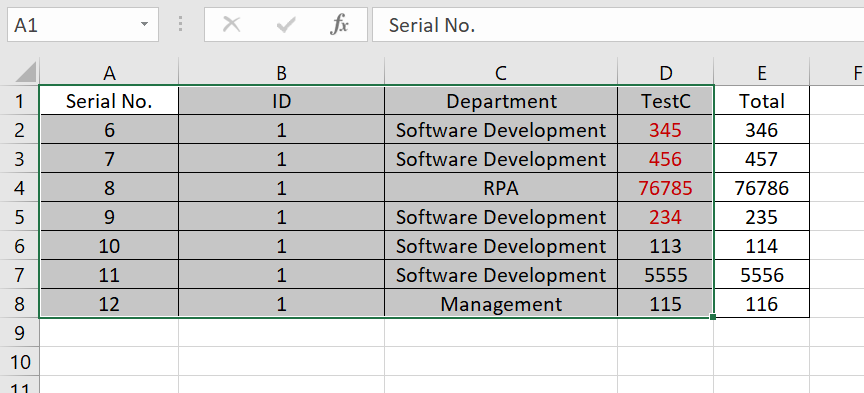

I tried the process with 1 Formula that defently worked (pictures attached) but even then, after inserting the Forumal the rest is missing
