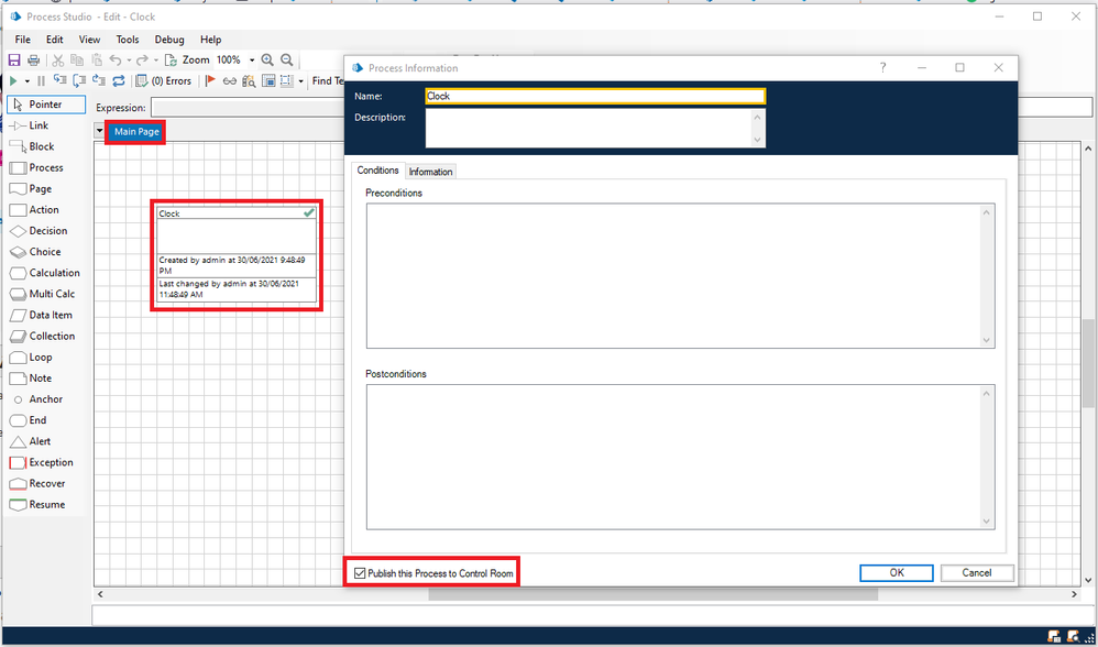

Hi team,
  How can I deploy a process  in to Control room-Session management-Available Processes field.
Thanks.
Srihari
RPA Developer
Hi Srihari,
You need to open your Process and go to the "Main page" and right-click on the "Process name table" and "Properties" and tick the box of the "Publish this Process to Control Room" the Process.
Then you can see the process in the control room.

Hi Srihari,
