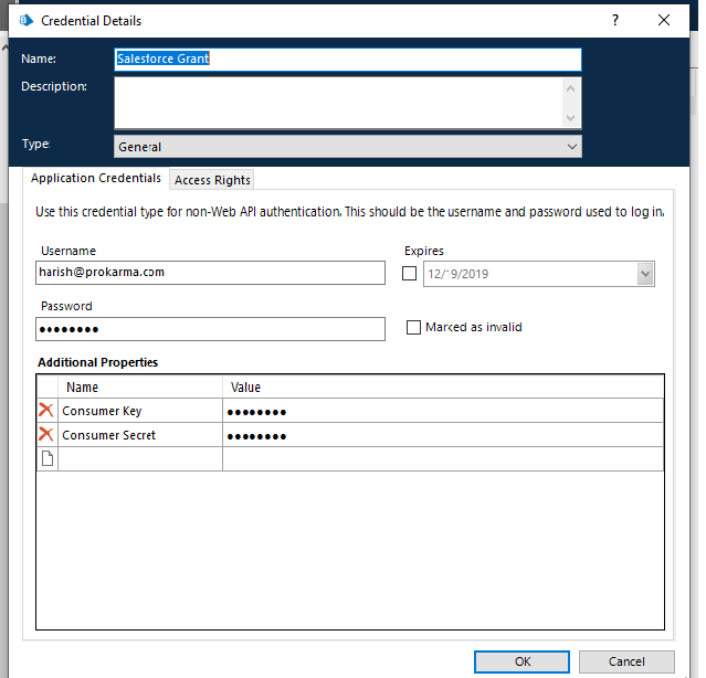

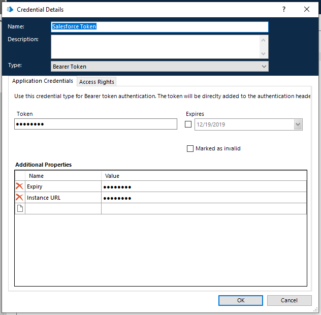

I am using Salesforce.com - Lightning Platform - Authentication skill for authenticating with credentials.I had created a salesforce token and salesforce grant in credentials. But I am getting the error "Internal : Current user is not permitted to perform this action".

This error looks like a credentials permission issue. Does the user account have permission to access the credential? You can check this in credential manager under the "Access RIghts" tab.

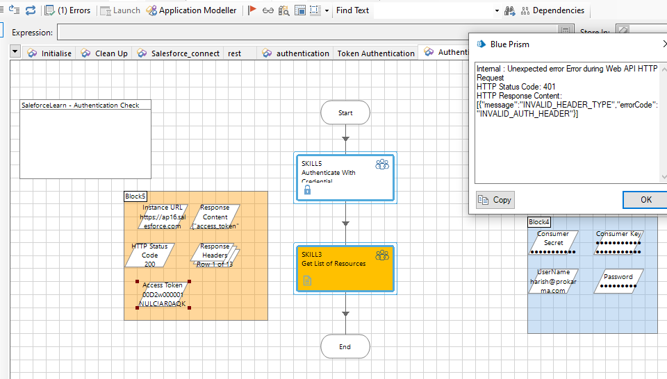

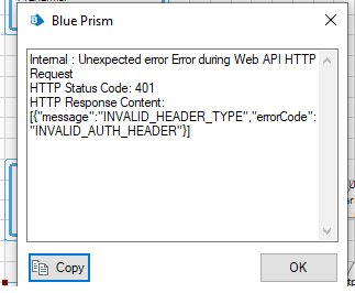

Thanks for the quick response.I had run into another issue. Sorry for bothering you much. I am new to blue prism.

Hmmm interesting... Which action is this occurring on? Authenticate with Credential or another action?

Hi Samuel,
It's for Get Record action in Salesforce General Skill. I am able to get Versions.

Do you have any solution for the above ISSUE? Still, I am not able to resolve.

Hi Harish,
Unfortunately I've been unable to recreate the issue so I'm not really sure what might be causing it.
here are a few thoughts to consider:
  • Have you called the Authenticate skill before calling the get record skill, and stored the access token in the Salesforce Token credential? If not, there is nothing for Salesforce to know the call is authenticated

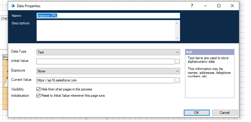

  • Is the instance URL you are supplying correct?
  • Are there any other actions that do or don't work which could help you figure out what might be the root cause of this?

I am getting instance URL from the salesforce token credentials dynamically as https://ap16.salesforce.com.I am passing the same instance URL in all actions in salesforce general skills.
