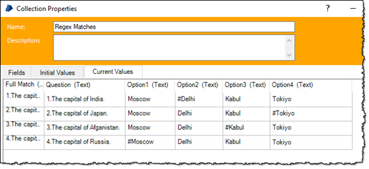

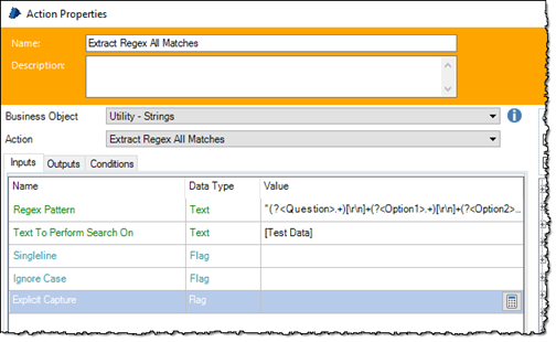

For the above data, you could use the Blue Prism "Utility - Strings" VBO (Blue Prism Digital Exchange - Utility - Strings). In it is an action called "Extract Regex All Matches" that you could pass the following Regex pattern:
(?<Question>.+)[\r\n]+(?<Option1>.+)[\r\n]+(?<Option2>.+)[\r\n]+(?<Option3>.+)[\r\n]+(?<Option4>.+)[\r\n]*
This action:

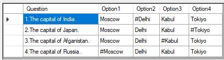

Will give you these results:
You could even use the "Delete Field" action in Blue Prism's "Utility - Collection Manipulation" VBO to remove that "Full Match" field.
