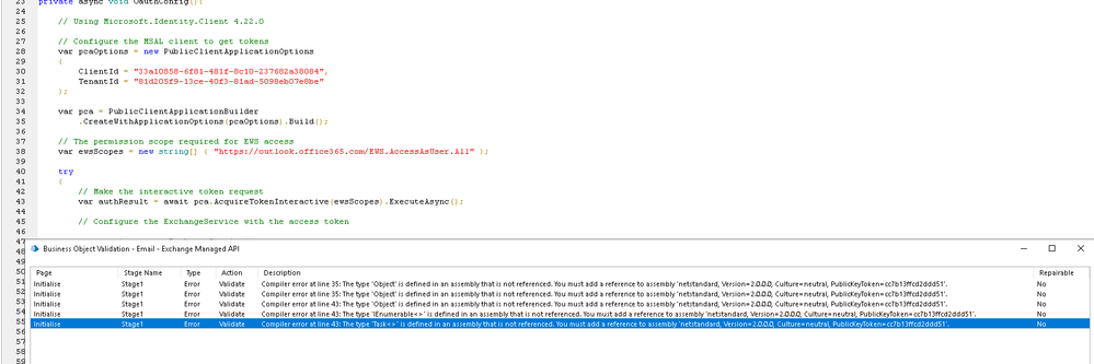

However when I run the code I get this error on every line I try to use the dll.
Initialise | Stage1 | Error | Validate | Compiler error at line 35: The type 'Object' is defined in an assembly that is not referenced. You must add a reference to assembly 'netstandard, Version=2.0.0.0, Culture=neutral, PublicKeyToken=cc7b13ffcd2ddd51'. | No |

A few screenshots for extra information.

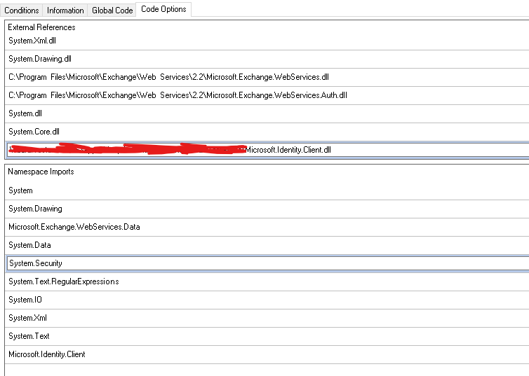

Try adding a reference to netstandard.dll to your Code Options -> External References settings.
Eric
30-11-22 01:22 PM
Eric

Adding the netstandard.DLL seems to have done it. I have no compiling errors anymore.
