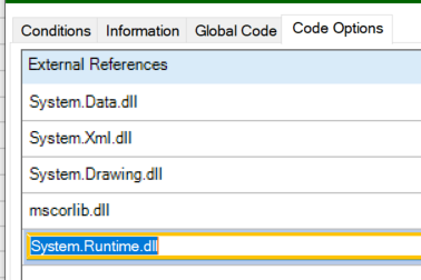

I wanted to share a simple piece of Blue Prism code that can be useful if you need to calculate the dates for the last Sunday and Saturday based on the current date.
Code options as Below
Input and Output Variables all in Date Format
