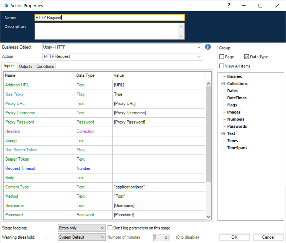

You did not specify which type of authentication you are dealing with. This is needed to determine how you would need to construct your HTTP request.
For example, if you are facing a simple basic HTTP authentication, you should be able to use the HTTP Request action straightaway by plugging in username and password, along with other resource related information. However the same cannot be said for more complex authentication methods like oAuth2.0, which involves a separate call to the authentication service to acquire a token and then use the token obtained for any subsequent web service calls.
If you are able to specify clearly on exactly what you are working with, more specific advices can then be given.

Hi Kumari,
Based on the info you have listed, I would envisage the VBO can be used in the following way.
Not sure if your proxy requires username and password. If not, just leave them as blank. I would also assume the username and password you had in the first post was what is needed for basic authentication, but not for proxy.
Also I am using the latest version of the HTTP VBO from the DX, if it appears different than yours.
If you are still not getting results, I would suggest you use a tool like PostMan first. This would help with any things you may have missed in understanding the web service. If you have managed to have that configured, it should be easy to map it to Blue Prism.
Lastly it was not clear to me where the error message came from, if it was the proxy or it was the API authentication process itself. Take a note of the 3-digit HTTP status code returned, that would help pinpoint the exact area you need to investigate.

Hi Bruce,
Yes, i have configured in similar way. In response i am getting access denied . Also, as you are asked, i am not getting any http error code in error. It's just the html tag i qm getting in response which has title as access denied.
K Sikha
Hi Kumari,
That is odd. It is worthwhile checking if your proxy requires credentials to be used. I have a feeling you were stopped before even made contact to the endpoint.
