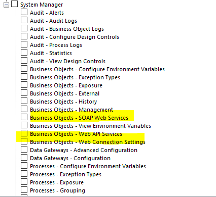

Hi Pradeep,
I suggest to check the access for  the role  you are currently in
Navigate to system tab>use role> Under permission check whether
"Business Object -  SOAP Web services"
"Business Object - Web API services" are selected.
If not selected, After you selecting the required access close the BP and open it

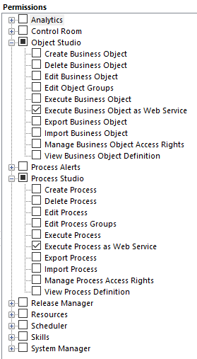

here are the permissions that are needed to execute a process as web service. The screenshot shows the effective permissions of the user role we actively use:
(Permissions under the System Manager node are for administrative tasks only and not needed for robots).
The user calling the exposed process has to have permissions to do so on process level (Studio tab) and VBO level, and all depending processes/objects. So if there is a process using Utility File VBO, then the web service user has to have execution rights on both, the process and on the Utility File VBO. The Execute Process/Object as Web Service permissions in Studio (tab) should be sufficient.
Depending on BP version different domain/user combinations are accepted. In order to be on the safe side better use  user principle names (UPN) in the format: [email protected].
