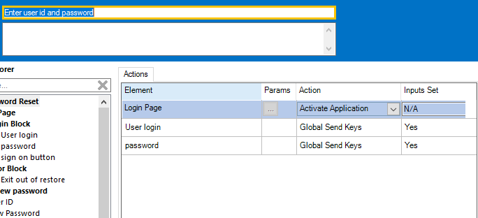

I have a process that launches a URL using Chrome and runs on a schedule. There is a login agent process that runs  before my process runs. When the schedule runs and I am not logged onto the HVD itself, the process is throwing the following error message, when attempting to enter login information. However, when I log onto the HVD, I can see my process running perfectly fine on the schedule.  Any ideas as to what may be happening? This appears to have just started this week. The login agent is working correctly and now runs a minute before my process.  I changed it to sooner based on another members response to my question, did not change the outcome.
ERROR: Internal : Failed to perform step 2 in Navigate Stage 'Enter user id and password' on page 'Login' - Access is denied

Hi rochan Gautam,
Before using the Global Send key, it is recommended to use the focus feature and, if possible, avoid using the Global Send key altogether by using the Write stage instead.
If you encounter any issues with the Global Send key, I follow below steps to narrow down the issue.
  1. Instead of using multiple actions in the navigation stage, use actions relevant to the particular field in one Navigate stage.
  2. Take a screenshot before using the Global Send key.
  3. Ensure that the screen is visible in UI mode. For example, if the website has a scrollbar and the intended field is not visible, using either the Global Send key or the Write stage will not work.
Possible issues that could be causing the problem might be: a) The virtual machine (VM) was not logged in successfully.  double-check all the login agent prerequisites. b) A software update notification is affecting the issue. For instance, if the bot is trying to enter the Global Send key at the same time as a software update notification appears on the VM, the focus  from the BOT might be redirected to the software update notification.
There could be numerous other factors that depend on the application, virtual machine technology, and organizational policy.
