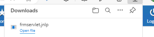

Unfortunately I do not have a solution/suggestion but I'm just commenting to say we are facing a similar issue. A link is clicked on an edge application which then shows the popup with the java file:
Then clicking on this opens up the java application. Sometimes this comes up in the popup first before being able to click open file:
Regardless, like yourself this all works fine apart from when we run it on the scheduler/control room where it error's intermittently. Every time I've tried to see what is happening in the VNC Window it works fine so I can't even replicate the issue, It's like it knows I'm watching lol.

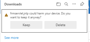

I have made a change recently so that once the link is clicked on the webpage, instead of it clicking open file it instead uses the Utility - Environment::Run Process Until Ended' action on the file in the downloads folder. This had worked the other day but Today it failed on the scheduler saying it couldn't find the file in the downloads. I have a feeling that the keep button message came up and it didn't click keep for some reason, but seeing as I can't replicate I can't prove it.
