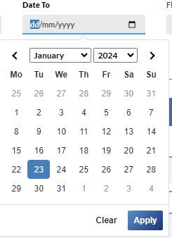

I am trying to select from a date Picker window within Chrome. I previously tried writing the date in the field using both a write stage and Global Send Keys, however the digits are scrambled.
I have devised multiple methods for selecting the correct date, the one I landed on being dynamically setting the Xpath attribute for the desired date. I know this works because I can highlight the desired date by using the "Select" Action within the navigate stage.
When I  try to use the "Click" action on the desired date, however, nothing happens...
 I have tried making it focus on the element before clicking, using the "Double Click" Action, changing the Element Type from "Table Item" to "Web Element". There is no Global Mouse click action available for this element.

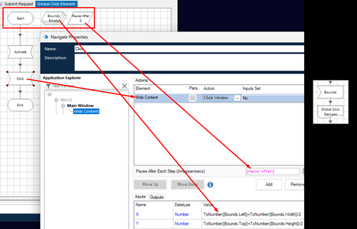

Calendars are a nightmare Ben, so try everything you can before resorting to spying the calendar elements. You can replicate a Global Click with a workaround - it's a bit of pain, but it works.
  • Spy the browser window and the inner 'web content' area using Win32
  • Create a Global Click page that activates the main window and clicks the inner area
  • Add a Bounds collection input to the page and use it to calculate the click coordinates
  • To click a web element, read its bounds and then make a reference to the new page, passing in the collection
Note that this method assumes the element is visible and not scrolled off page.
