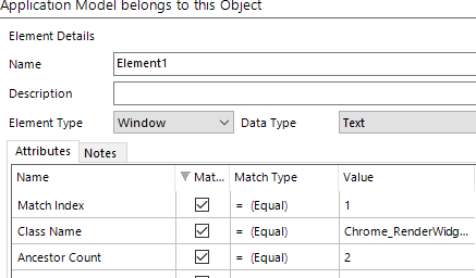

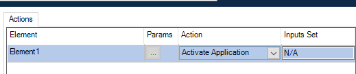

I spy Chrome with Win32, a and using navigate stage and action "activate application" action.
This is from app modeler
28301.pngand this is from navigate stage
