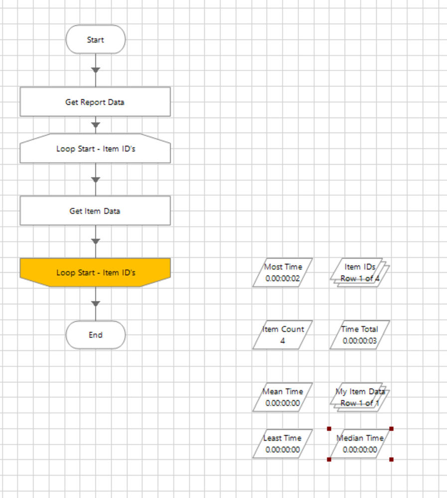

Hi Arjun,
For MI Reporting, we have created a lot of reporting process in past. The best way to do this is by using the 'Get Report Data' and 'Get Item Data' as pointed out before. However, here one thing I would add is that if you are using just one queue, reporting is fairly easy as you can sync every item data against the respective item ID.
However, if you are using multiple work queues then I would suggest to have a Item Key also in place which can help you to sync the correct data from both queues for any given item ID. For your reference, just find a sample workflow which can give you both Item ID's and also the Item Data. You can create further logics to combine both of them or write the same in some excel file.
