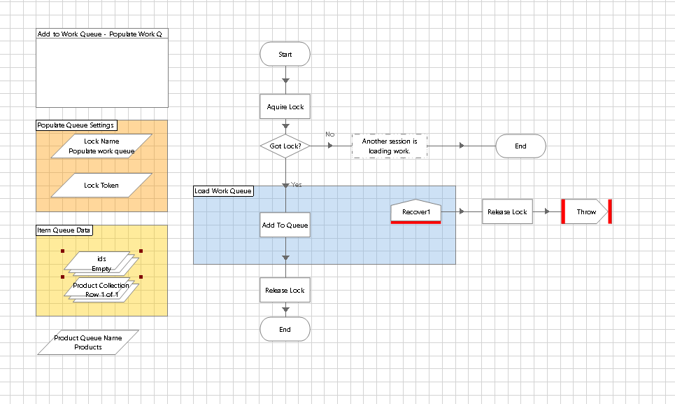

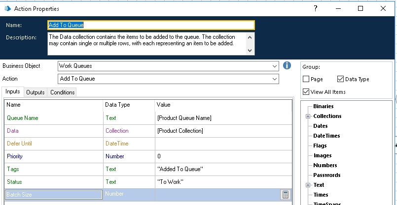

I wonder if anyone has had a similar experience. I have exposed a business object that simply adds items to a work queue. the Business Object accepts a collection for this test the collection is one field called product that is of type text. I use the work queue action, "Add item to work queue", I define the input parameters and I have an output collection "Item IDs" for the output Item IDs of the work queue.
When I run this object withing BP with the debug tools and a single row of dummy data, this all works fine.

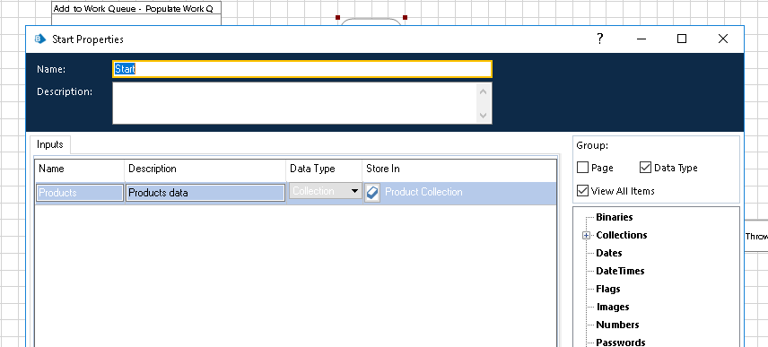

I don't have a variable named "Item ID" that I'm passing from Appian to Blue Prism, there is the (default) output variable that is required for the "Add To Work Queue" Object but I am not passing this as a variable. I only have one variable set up to be passed into the input collection, which is a variable called "Product".

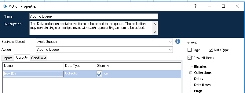

Thanks for explaining your problem. did you define any fields in "ids" output collection?
Athiban
thomasDamms
this is where I stored the output variable "Item ID" from the work Queue action.
Update:
I have just removed the field definition on the ids variable, meaning its now a blank collection and this has allowed to process to complete successfully. thank you for your help, Athiban.
I did not know that having the collection defined would cause a SOAP error when the object is called, I assumed that because I was not passing the collection into the start or end parameter, that this collection would be ignored with regards to the process parameters required. good to know.

Hello Thomas,
Glad to hear that you were able to resolve the issue. The issue is not related with your SOAP design. By default, output collection in the Add to queue action will expect a field called "Item ID". Since you had mapped a user defined collection to the output collection, BP was expecting the "Item ID" field in the output collection. Hence it has thrown the below error "Internal: Collection fields are defined but cannot be matched to the incoming collection - The collection definition does not contain the field Item ID".
(Note: If we map collection without defining any fields then BP just creates the "Item ID" field on its own)
