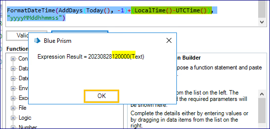

Seeking for your help I was trying to get yesterday's date together with timestamp but seems the below format I have use is not working 😞 because I got 120000
Ann
Ann Fajardo
7 REPLIES 7
mamichielsen
Hi Ann, what are you getting if you take out the local time and UTC Time, and instead going FormatDateTime(AddDays(Today(), -1), "yyyyMMddhhmmss")
Melissa Michielsen
Junior Automation Developer
TransAlta
Hi, Michelsen.
Got the same result if I was going to remove the UTC
Ann Fajardo

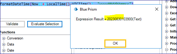

Hi Ann,
Use FormatDateTime Expression instead of FormatDate. And use Now() Expression instead of Today(). It worked for me.
For more expressions, you can expand Functions of Date.
Vinod
vinod ch
Hi, Vinod.
Thanks for the reply yes that's working but I need the yesterday's date instead 😞
Ann Fajardo
Use "(AddDays(Now(), -1)" as part of your logic. That will give you expected results.
