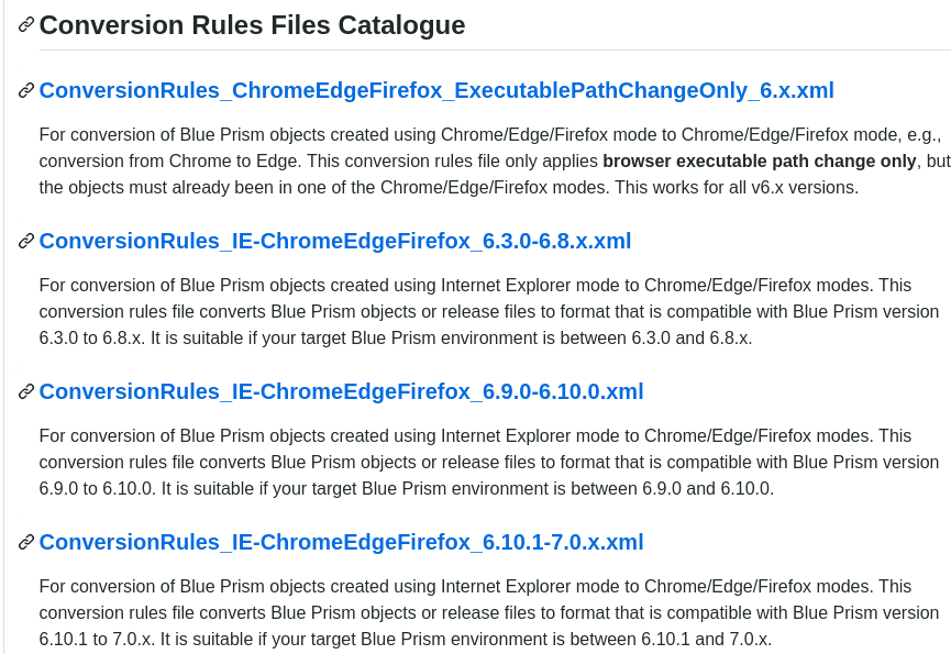

Hi Sankar,
Application Modeller Conversion Tool only cares about your target Blue Prism version where modern browser mode will eventually be used. Please kindly generate the Application Manager Operations.html file from your target Blue Prism version, and select the most appropriate Conversion Rules file for your target Blue Prism version as well. For the latter, there is a conversion rules file supporting conversions from v6.3 all the way to v7.1 at the time when this was posted.
Hope this helps.
