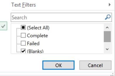

I have managed to create a custom Excel object which includes a filtering feature. However It works well when only a single criteria is used... I am attempting to filter only records that have "Failed" written, or that have "blank values" in the field of interest using the following code:
Dim worksheet as Object
Worksheet = GetWorkbook(handle, Nothing). ActiveSheet
worksheet.UsedRange.AutoFilter (Field:= fieldToBeFiltered,  Criteria1:=criteriaToFilter, Operator:=2, Criteria2:="=")
However when running the process showing Excel output, only the "Blank" cells are being selected to be filtered, leaving out the "Failed" rows:
How can I proceed to correctly use more than one criteria fo the filter please?

Please check this documentation from Microsoft: https://docs.microsoft.com/en-us/office/vba/api/excel.range.autofilter
There is an example how to filter by several values:
Hope you will be able to update your code and make it work.
