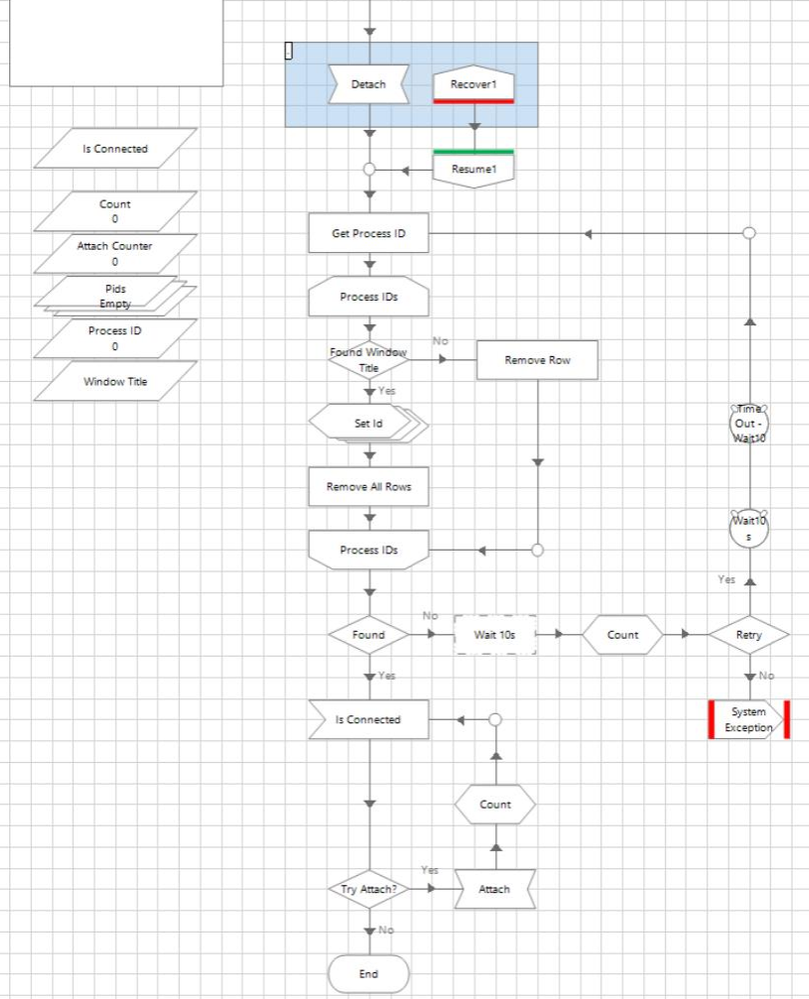

I have a process running with MS Edge and while running it in debug everything works as expected but every time I ran it via Control Room or Scheduler I keep getting attach errors.
At my company we're running BP 6.10.3 and have the browser extension.
Anyone experienced this and have a solution or ideas how to improve it?
I have tried to add --force-renderer-accessibility but it doesn't seem to done anything major to fix the errors.
My attach page:
I have tried using only window titles but in my experience process id generally more stable.

Hi @Johan Sörman
Are you executing the process in the same machine? Or you debug in one and execute the process in a separate Digital Worker?
If yes, the browser have the same version in both machines? Is the browser extension installed and executing will trying to attach?
One simple consideration, put a little wait stage between try and try in the Attach part of the end. Just to wait. When we debug a process we take several seconds between step and step. It's best practice to include a wait stage following every interaction with the application.

Hello @PabloSarabia ,
I realized the screenshot was from an version this morning. I got same suggestion from a co-worker in a different RPA team but given a wait/sleep doesn't do much.
I'm running debug and schedule on same machine.
Right now it's working somewhat decent but it's using a wildcard for window title, process and child index. I'll see how long it lasts but not really trusting edge and BP after months of issues similar to this.​

Hi @Johan Sörman
Just to check, how are you attaching the browser? (input parameters in the navigation stage)​
Did you see how the browser is launched?
