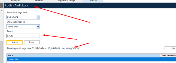

I need guidance on how to consult user information by consulting the audit log, ex:
In this case, I need to consult the user "ual.jbj" on a specific day and thus analyze the performance logs on the server.
Can anyone advise how to query this table?

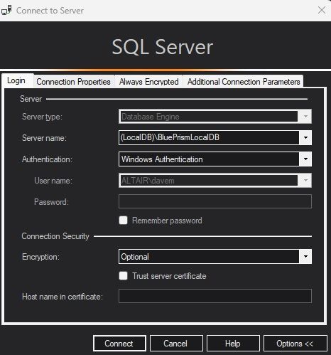

When you open SSMS, it will ask you to enter login details. This is where you'll input the Database Server Name and authentication details. This part I can't really help you with directly for real databases because I won't know any of those details. But for the Learning Edition, most likely the details will be this:
Server Name: (LocalDB)\BluePrismLocalDB
Authentication: Windows Authentication

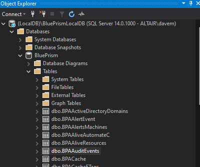

Once you've connected, expand the nodes out like this: (LocalDB)\BluePrismLocalDB > Databases > BluePrism > Tables > dbo.BPAAuditEvents

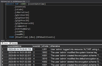

You can then right click on dbo.BPAAuditEvents and choose "Select Top 1000 Rows" which will open a query window and will do a quick query that will look like this:
From here, you can play around with determining exactly which fields you want and such. I don't know what purpose you're doing this for so I don't know how to suggest further steps. You could call this query from inside a Blue Prism process, a PowerShell script, or just manually go do these queries in SSMS periodically. But if you're just going to look at a particular user's activity, you can and should prefer doing that from in the Blue Prism UI.
