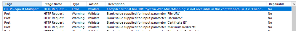

16-02-23 02:48 PM
The HTTP VBO and the JSON VBO should both have a version number listed on the Initialise tab. Can you post screenshots of those?

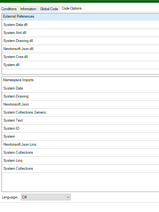

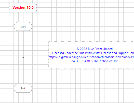

17-02-23 08:17 AM
Hi @ewilson
The first is the Json to collection
The next is HTTP
Thank you

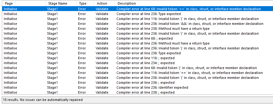

17-02-23 01:42 PM
Matthew,
Thank you for being a SS&C Customer and for using SS&C Blue Prism.
In connection with the JSON asset, could I ask you download it again from the DX? The reason being I have been adding functionality to it this week and to be honest your error looks like C# code is being validated by a VB.NET parser. I could be wrong, but that's what it looks like.
The current version, which I posted yesterday, is V10.0.1 and has 2 new actions for working with JsonPath. This might resolve at least some of your issues. With regards the issues shown for the HTTP VBO would require a little investigation, could you advise the version of Blue Prism you are using?

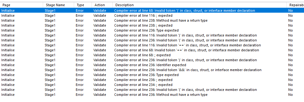

20-02-23 08:34 AM
hi @Geoff Hirst
I have downloaded the latest version and still have a handful of errors below. We are also using V6.7.2

20-02-23 08:52 AM
Hi Matthew,
Could you take a look at the initialise page of the Json asset. Does yours look like this?
The areas in yellow are the important bits to determine if you have the most current version (you may not have, I only posted it back to the DX last week and it may not have made it through QA).
If we can determine that then at least that will explain that. If I look at the error list on my machine for this asset it doesn't show any. So we need to see what is causing this issue for you. There is a national holiday in the US today, so I will assist you as much as I can.

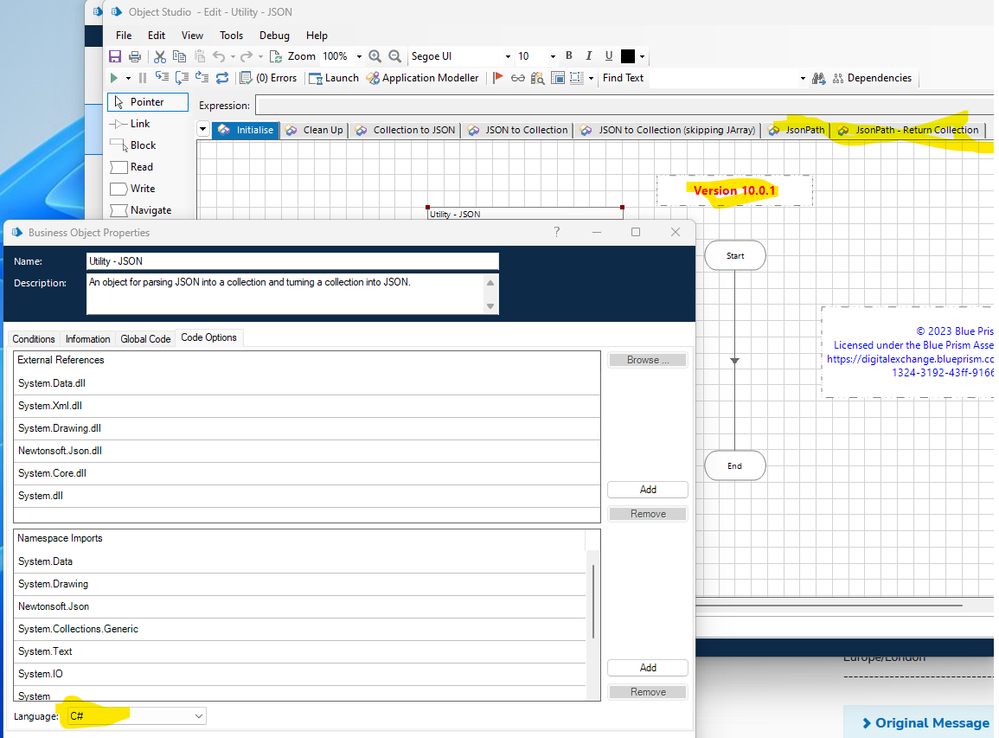

20-02-23 10:35 AM
@GeoffHirst
Please see screen shot below, looks like the latest one.

20-02-23 11:49 AM
Hi Matthew,
That screen of dependencies actually hasn't changed, I was just interested to see that your version was set to C# which it is. What we need to look at is the version number on the initialize page. If you have the latest, then its 10.0.1.
Can you also provide that list of errors as a full window, so that we can see which asset is actually causing the problem as right now I can't replicate what you are seeing but we will get to the bottom of the problem.
