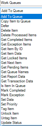

After moving to BP 7.1, we started seeing lots of exceptions (in 1000s) due to "Execution Timeout Expired" error on random queue actions. This is happening only on internal objects actions like Queue actions - Mark Completed, Mark Exception, Update Status, Tag Items, Get Next Item, etc.
