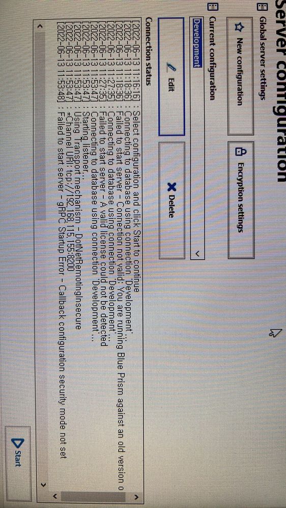

We have upgraded the BP from 6.8.1 to 7.0.1 and ASCR setting remained as default with its port = 10000, hostname = localhost, callback = gRPC.
We changed the port number to 20000 for try and fortunately, the server started successfully at the moment.

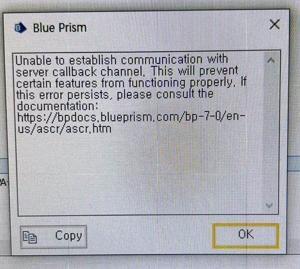

Since then, we have tested the RR by drag-n-drop the process from the control room, when we came across the following error:
Would there be any way to troubleshoot this?

I have the same issue, page is not loading and getting the error -
Unable to establish communication with server callback channel. This will prevent certain features from functioning properly. If this error persists, please consult the documentation: https://bpdocs.blueprism.com/bp-7-3/en-us/ascr/ascr.htm

Thanks, I was able to resolve this error by opening inbound port 10000 on the App Server.
