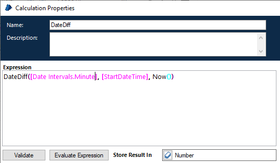

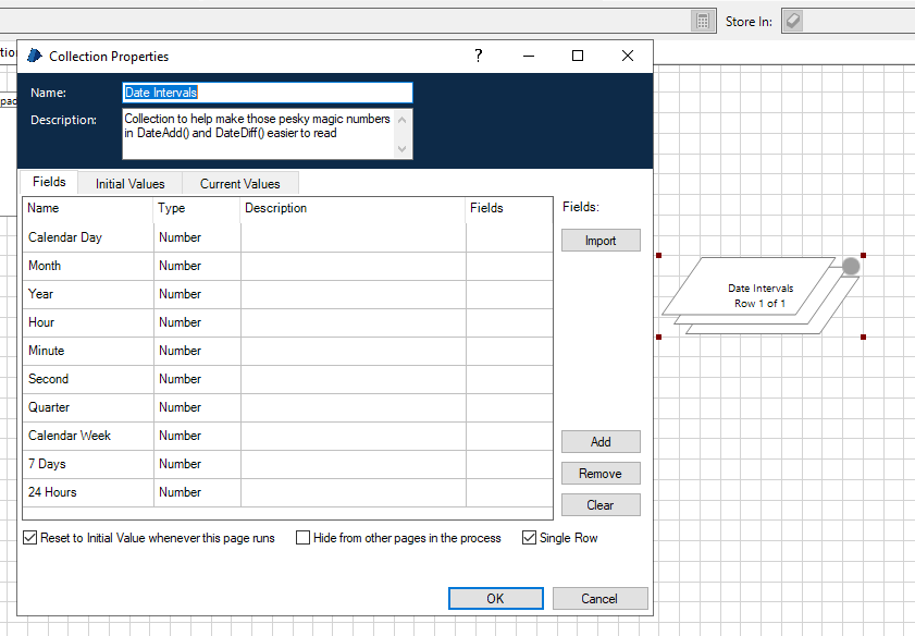

To make this stuff easier to read - and easier to write as well - I create a one-row collection called Date Intervals, and make it globally visible
Initialise all the fields to the secret magic numbers from the Blue Prism help file:
Now I can refer to [Date Intervals.Minute] instead of "6", and it's easy to understand what the calculation's doing:
Just copy the one-row collection to any object or process to enjoy never having to work out those pesky Date Intervals again 🙂
