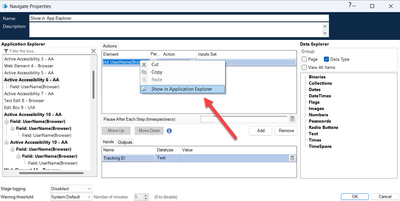

  1. Find the Element in Use: If you know where the element is used, open the stage containing it.
  2. Use "Show in Application Explorer": Right-click the element in the stage and select Show in Application Explorer.

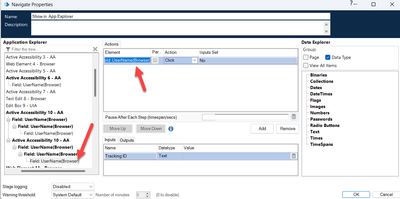

  1. Identify in the Application Explorer: The selected element will be highlighted in the Application Explorer panel on the left side.

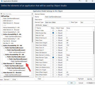

  1. Open Application Modeller: After using Show in Application Explorer, open the Application Modeller, and the same element will be focused and visible.
This technique saves time and effort, making it easier to work with existing elements regardless of how they are structured in the Application Modeller.
To illustrate this scenario, I intentionally used similar names for most of the elements in the Application Modeller. This setup highlights how difficult it can be to identify the exact element in the Application Modeller, even when searching through the Application Explorer.
By using the Show in Application Explorer functionality, you can quickly locate and highlight the specific element, streamlining the process even in cases where naming conventions are unclear or elements are poorly structured.
