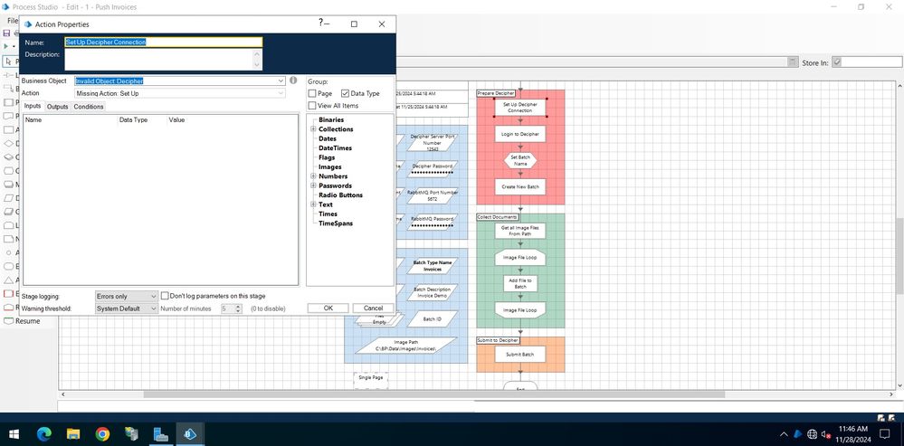

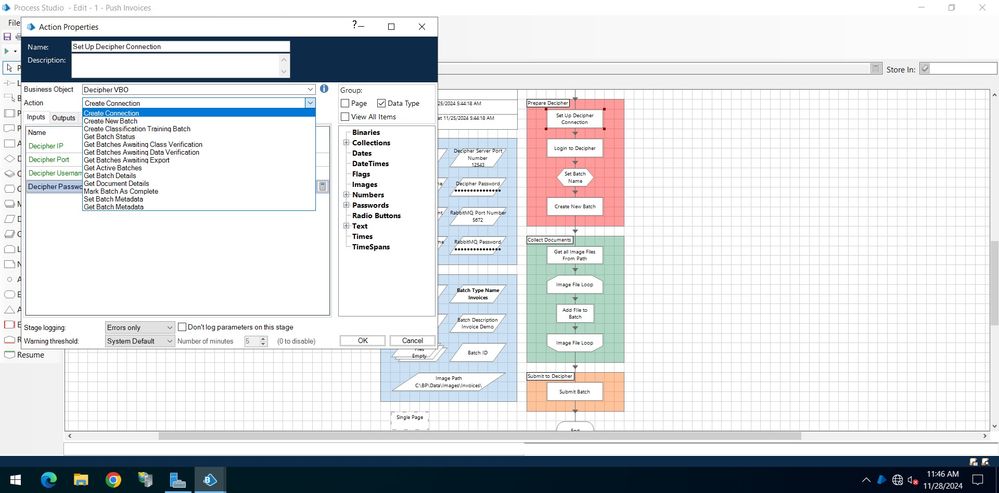

I was trying to access my Decipher process to run some tests, but (even though I had used it previously) it tells me that an "Object Decipher" cannot be found. I checked to see if the actions I needed were available in the Decipher VBO, but not all of them are there.
I wanted to know if I need to update the VBO or downgrade it. Does anyone know?

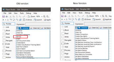

There was an update to the VBO and DLL in the V2.3 release. When I compared the old and new VBOs, I noticed that the actions you're using have been replaced by new actions. So, you'll need to import the new VBO and update your process accordingly.
The steps have changed significantly, so we had to create an entirely new process.
