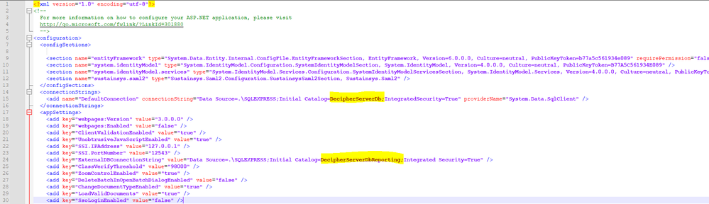

Hi All,
Just updating the solution here in case if anyone faces the same issue in future.
The connection string in Web config and Server Config file should be same. Also, the connection string should have the DB as mentioned below i.e line 15 should have main DB name and line 24 should have reporting db name
