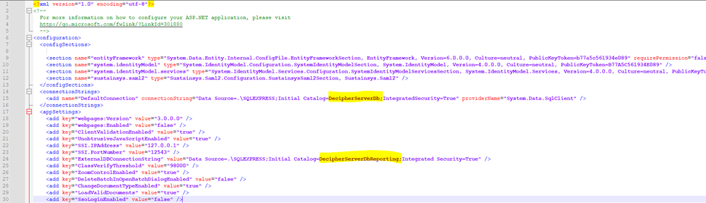

we also faced similar issue in v2.2. Upon investigating further we found that the connection string was not mentioned properly in the web.config file. can you please check your web config file?. The connection string in Web config and Server Config file should be same.

 We have the exact connection string in web config file, do you mind sharing the server config file connection string (SsiServer.exe.config.).

Here it is. Incase if you have the correct connection strings, then I would advise you to raise a support ticket to resolve the issue.

I forgot to mention one more point. In the web config file, line 24 should have reporting database name in the connection string. (We got this solution from support team)

@Ben.Lyons1 @Athiban Mahamathi Mathialagan Thanks for your suggestions,
While installing the decipher server we did not check the box for enable reporting database, we are assuming that is the issue. As of now we have scheduled a support call to go through the issue.
