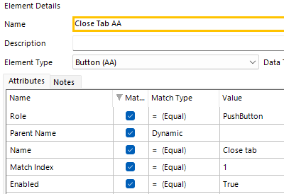

You can spy the close button using the tab name as a dynamic parameter, something like this (UIA works too):
And you can activate an AA tab using the 'default' action:

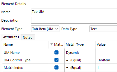

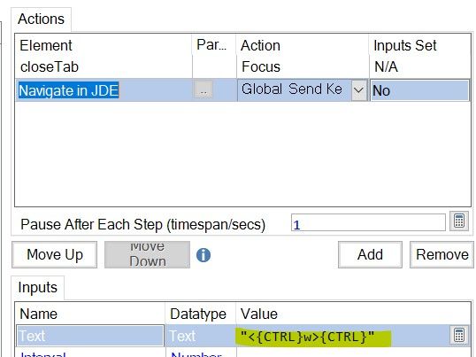

You can activate the specific tab and send the GSK with "^w" (ctrl+w).
This will give you exact results for closing the tabs in Edge application.

I spied the Tab using this:
and in the navigation, i use focus and navigation. Is it wrong?

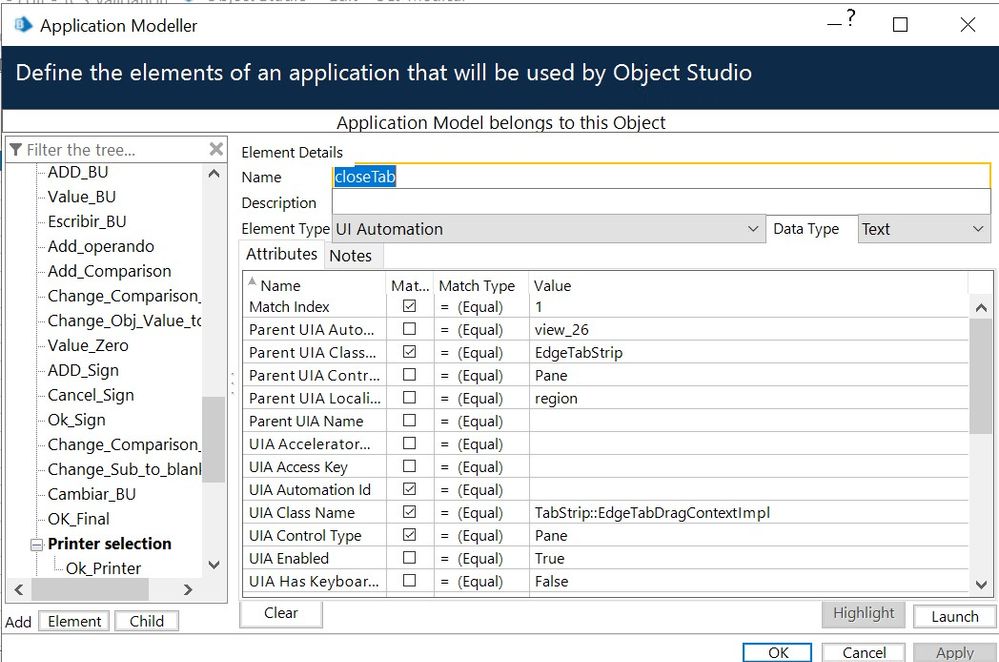

Yes i use it (see image below), the issue is due the I use a focus first and it generate an error due it loses the map/spied field frequently (I spied the tab with the X) and i have to Re-Spy the tab again.

Dear Carlos,
If your Browser tab already visible Infront of you then you don't need to spy, you can just activate the application and use Global Mouse Send keys (Preferred).
I could see that your using Global send key events.

Hi Syed,
Do you mean, replace the "FOCUS" with other command?. Could you please send me an screenshot?. I am not sure how activate it before execute the GSK.

Dear Carlos,
Drag and Drop the Application Modeler Root name or Target Application name (While creating the application modeler you will be giving the name) on to the Navigation stage and select the Activate Application. After that use the Global Send Keys.
