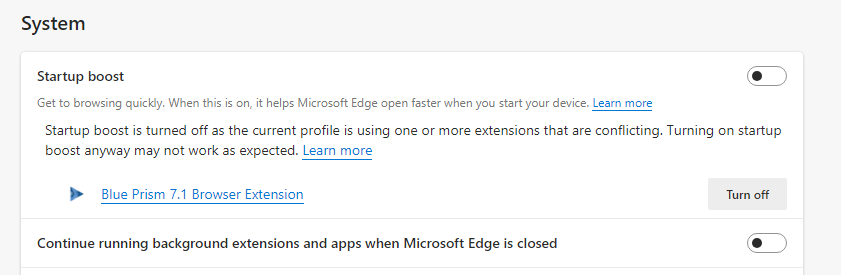

  2. Object 2: Does the functional part. Which is having Attach issues when running from process. It always gives out the browser extension issue when the browser was launched from a different object.
Have the below setting configured as well.
Why is this issue happening? Is there a necessity that the browser should be launched within the same object?
