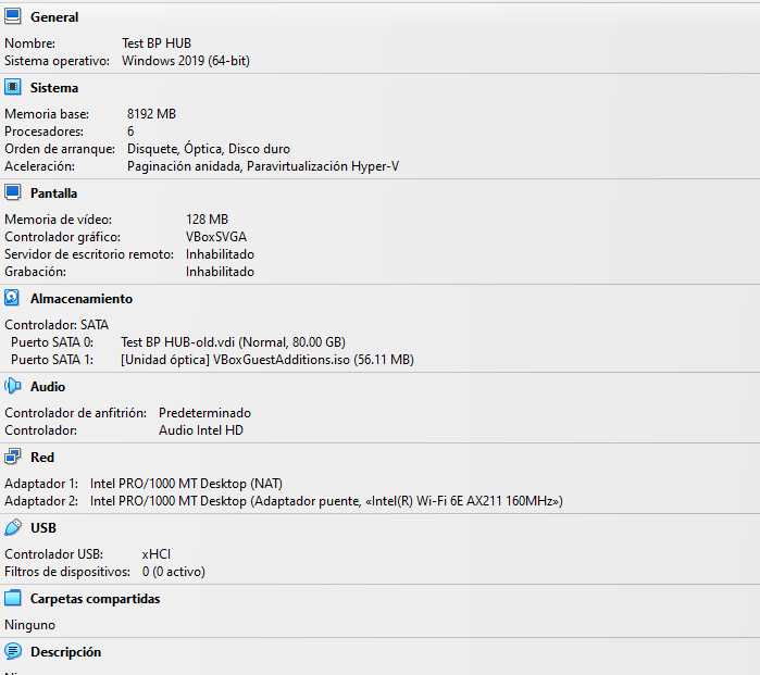

Hi, thanks for your support. As you can see, these are my VM (VirtualBox) hardware specifications.
I tried to install Hub with these specs, but it doesn't work. I’m also attaching a video showing the error.

If you're not able to provision additional CPU resources for this VM, I'd suggest as a workaround to stop services that are not essential while the installer is running.
Stopping the following services that are not required during installation can free up resources:
  • Blue Prism - Audit Service Listener
  • Blue Prism – Log Service
  • Blue Prism Server
  • Decision Model service
  • SQL Server LaunchPad
  • SQL Server CEIP
