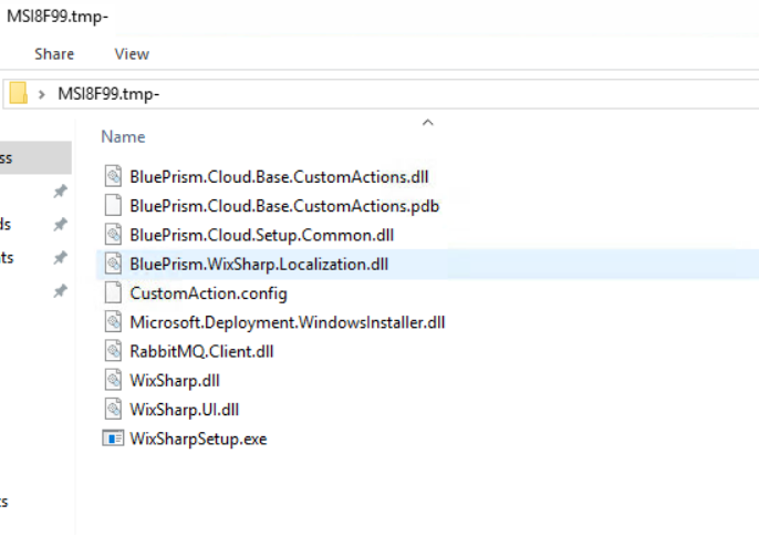

Hi @Chris.McGowan (sorry, idk how to mention shortly), thanks for your interest.
Actually, I have found out, why this issue occurred. It seems that our security cloud solution called Carbon Black (CB) Defense is blocking the connection between App and DB server.
However, I tried installing previous version of BP HUB v4.5, which also is getting blocked by the CB, but in a different manner. Maybe you had such experience.
I have found a event in the Application logs, which states the following:
Information: The script "C:\windows\installer\msi45c.tmp" attempted to load the library "bcrypt.dll" by calling the function "LoadLibraryExW". The operation was blocked and the application terminated by Carbon Black Cloud.
There are some custom actions for installation purposes, which as I understand, try to encrypt some configuration files for HUB DB tables. The action is called 'SetEncryption' under the 'BluePrism.Cloud.Base.CustomActions.dll', that gets blocked every time it tries to run this specific action/function.
The security support team is asking to provide additional details on what is the purpose of these files, I guess that there is no way, I can get this information, but it is just interesting if anyone had experienced something similar...
