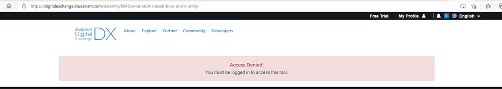

27-06-21 10:21 PM
could you please advice how can i get the Replace in Worksheet excel VBO. i am unable to download due to access denied. we are in need as our windows 10 upgrade impacted lot of our process excel spying objects, and we are in the process of removing spying objects and use default Excel VBO.
could you please provide the code for : Replace in Worksheet, so i can modify the Excel Vbo .
Satya
Satyanarayana chinnapareddy
28-06-21 01:44 PM
Is the access denied message being displayed by the Digital Exchange, or your corporate firewall? Were you logged into the DX?
28-06-21 01:51 PM
Thanks for your response.
i was able to login into DX and able to download other assets except the below link:
https://digitalexchange.blueprism.com/dx/entry/9648/solution/ms-excel-blue-prism-utility
i even logged a ticket as well, still waiting for support team response.
Satya
30-06-21 12:30 PM
Got the same problem. Access denied to https://digitalexchange.blueprism.com/dx/entry/9648/solution/ms-excel-blue-prism-utility
No problem to download another assets
br
philippe boutry
Blueprism Solution designer
Aubay
Europe/Paris
