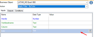

Hi @NicolasSahli , you can filter the Excel file by color here like the example below:
You can use this action in MS Excel VBO the action called "Apply Filter - ByColor" then pass the color value

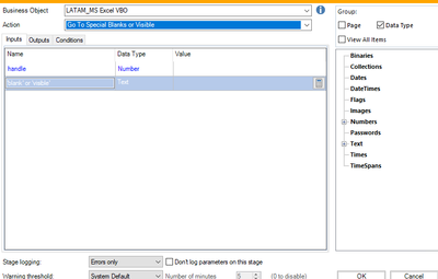

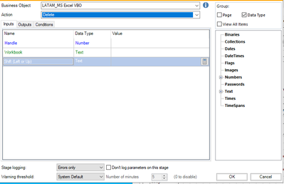

To delete if you have a lot of rows you can got to special to select visible only, also in MS Excel VBO, and use other action to delete
