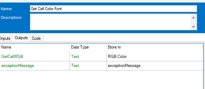

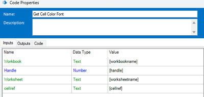

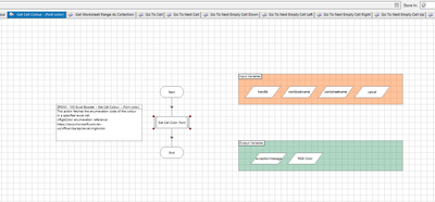

You can add a new action that can give you the RGB Codes
1. Go to the object studio SGPMI MS Excel  Booster
2 Add a new action and name it for example (Get font color)
3 Add this code
Try
dim C as long
dim R as long
dim G as long
dim B as long
C = GetWorksheet(handle, Workbook, Worksheet ).Range(cellref,cellref).DisplayFormat.Font.Color
R = C Mod 256
G = C \ 256 Mod 256
B = C \ 65536 Mod 256
GetCellRGB = "R=" & R & ", G=" & G & ", B=" & B
Catch ex as exception
exceptionMessage = ex.message
End Try
for Input provide this
For output this :
And you will have an output like this for example if your cell font is in red, you will have  <R=255, G=0, B=0>
Hope it will help you

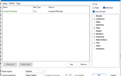

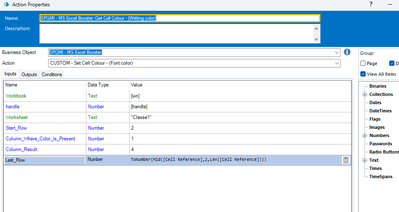

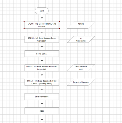

Hello @sumire

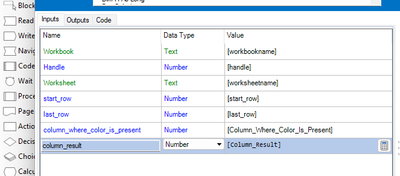

You need to create a CUSTOM Action Like this for example :
For inputs you put :
Notice :
column_where_color_is_present is the index column. In your case it's column A, so you put 1
column_result is where you stock the result so you can put  2 or 3 depends on where you want to stock your values.
For Ouptut  :
And inside the code you put this
Try
Dim C As Long
Dim R As Long
Dim G As Long
Dim B As Long
Dim i As Long
For i = start_row To last_Row
If Not IsDBNull(GetWorksheet(handle, Workbook, Worksheet).Cells(i, column_where_color_is_present).Value) AndAlso Len(GetWorksheet(handle, Workbook, Worksheet).Cells(i, column_where_color_is_present).Value) > 0 Then
C = GetWorksheet(handle, Workbook, Worksheet).Cells(i, column_where_color_is_present).Font.Color
R = C Mod 256
G = C \ 256 Mod 256
Dim GetCellRGB As String = "R=" & R & ", G=" & G & ", B=" & B
GetWorksheet(handle, Workbook, Worksheet).Cells(i, column_result).Value = GetCellRGB
Else
GetWorksheet(handle, Workbook, Worksheet).Cells(i, column_result).Value = ""
End If
Next i
Catch ex As Exception
exceptionMessage = ex.Message
End Try
You need to make a loop to find your wanted results, we make the loop inside the vbo 🙂

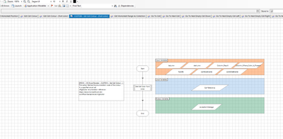

Your process should look like this
Your CUSTOM VBO inputs in the process like this :
Ensure that you dont have empty value inside your column A

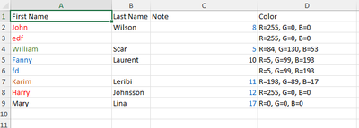

At the end you will have this results
Please mark as best answer if my code helped you 🙂
regards

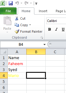

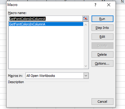

Dear @sumire

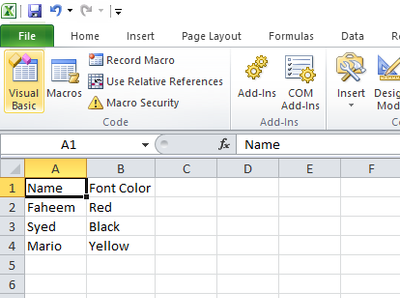

We can achieve this with the help of macro code.
Create an Excel template with the macro enabled workbook and copy all your original excel data into the Macro Excel template and then Run the Macro with the help of Blue Prism. output will be created in the Sheet2 and you can read the Sheet2 data as a collection in Blue Prism.
My Excel Data
My Macro Name: GetFontColorsInColumnA
After running the above Macro output will be generated in Sheet2
Macro Code:
Function GetColorName(colorValue As Long) As String

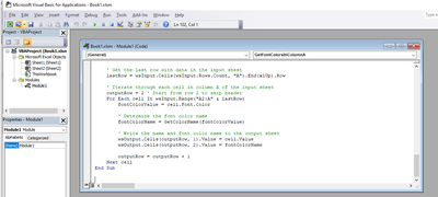

Sub GetFontColorsInColumnA()
Dim wsInput As Worksheet
Dim wsOutput As Worksheet
Dim cell As Range
Dim fontColorName As String
Dim fontColorValue As Long
Dim lastRow As Long
Dim outputRow As Long
' Set the input and output worksheets
Set wsInput = ThisWorkbook.Sheets("Sheet1")
On Error Resume Next
Set wsOutput = ThisWorkbook.Sheets("Sheet2")
If wsOutput Is Nothing Then
Set wsOutput = ThisWorkbook.Sheets.Add(After:=ThisWorkbook.Sheets(ThisWorkbook.Sheets.Count))
wsOutput.Name = "Sheet2"
End If
On Error GoTo 0
' Clear any existing data in the output sheet
wsOutput.Cells.Clear
' Write headers to the output sheet
wsOutput.Cells(1, 1).Value = "Name"
wsOutput.Cells(1, 2).Value = "Font Color"
' Get the last row with data in the input sheet
lastRow = wsInput.Cells(wsInput.Rows.Count, "A").End(xlUp).Row
' Iterate through each cell in column A of the input sheet
outputRow = 2 ' Start from row 2 to skip header
For Each cell In wsInput.Range("A2:A" & lastRow)
fontColorValue = cell.Font.Color
' Determine the font color name
fontColorName = GetColorName(fontColorValue)
' Write the name and font color name to the output sheet
wsOutput.Cells(outputRow, 1).Value = cell.Value
wsOutput.Cells(outputRow, 2).Value = fontColorName
outputRow = outputRow + 1
Next cell
End Sub

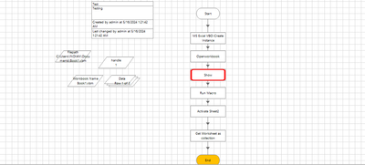

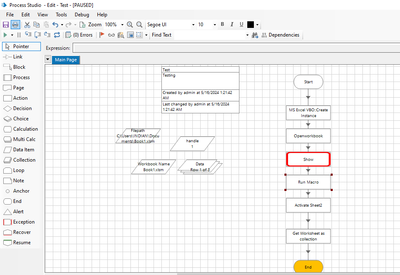

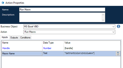

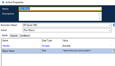

Please use the above macro code in the excel workbook.
Open the Excel work book with Blue Prism and Run the Macro as shown in below
Please try this and it will give the the response with in seconds and let me know if you have any doubts on this

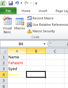

Dear @sumire
We can achieve this with the help of the macro.
Create a Excel template with Macro Enabled workbook, copy your original excel data into the Macro Enabled workbook and the run the macro which will give the results in Sheet2
Sample Excel Data
Macro name and Macro code: GetFontColorsInColumnA

Please add the above code in the Macro Enabled worksheet

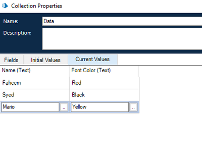

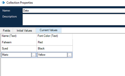

My output:
Try with Blue Prism to generate the output in Sheet2 and read as Collection
Please try the above approach and let me know if you need any help.
